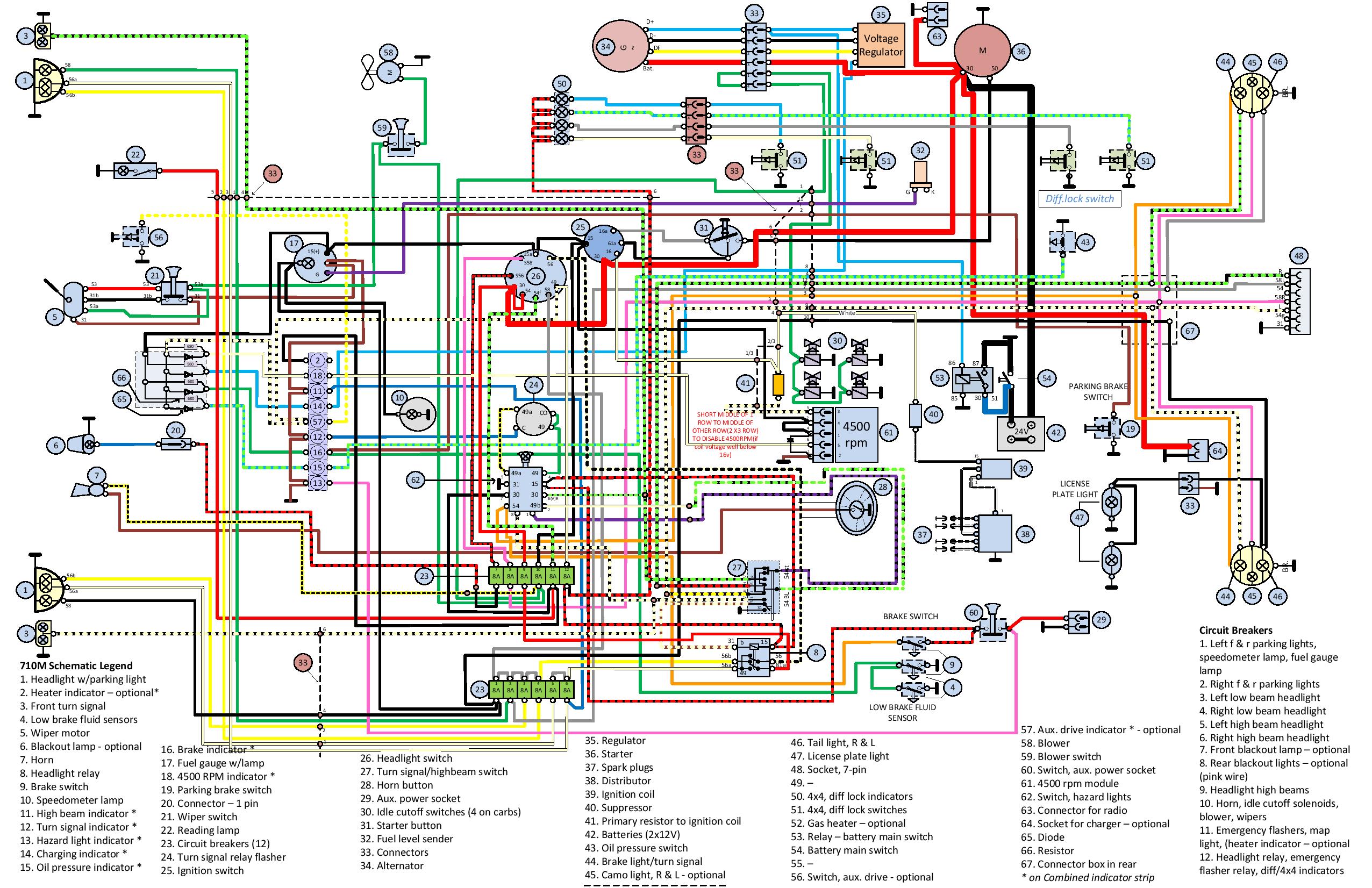

710 - 712 wiring schematics PDF and JPG.
PDF download is more ideal for printing.
pinz color wiring.pdf
(355.73 KiB) Downloaded 648 times
pinz starting circuit schematic.pdf
(496.13 KiB) Downloaded 597 times
pinz color wiring-page-001(1).jpg (797.5 KiB) Viewed 6826 times
