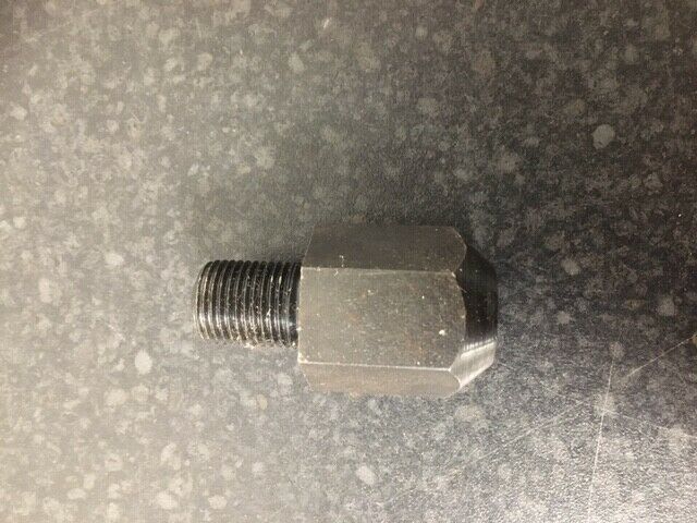

Are you running 3 wheel studs per wheel?
Garrycol
Posts: 423
Location: Canberra Australia
Re: New Tires 315/75r16
Post by Garrycol »
No my wheels run 6 wheels studs per wheel - I guess your comment comes from the fact that in my pic three lug nuts are visible due to their brown colour. On the 101 three of the lugnuts are of a standard style and you cannot see these as the are close to the same colour as the wheel. The wheel step (not shown) uses a different lug nut (three off) that allows the wheel step to be bolted on - these are the three you can see.
Here is a pic with everything in place
Garry
