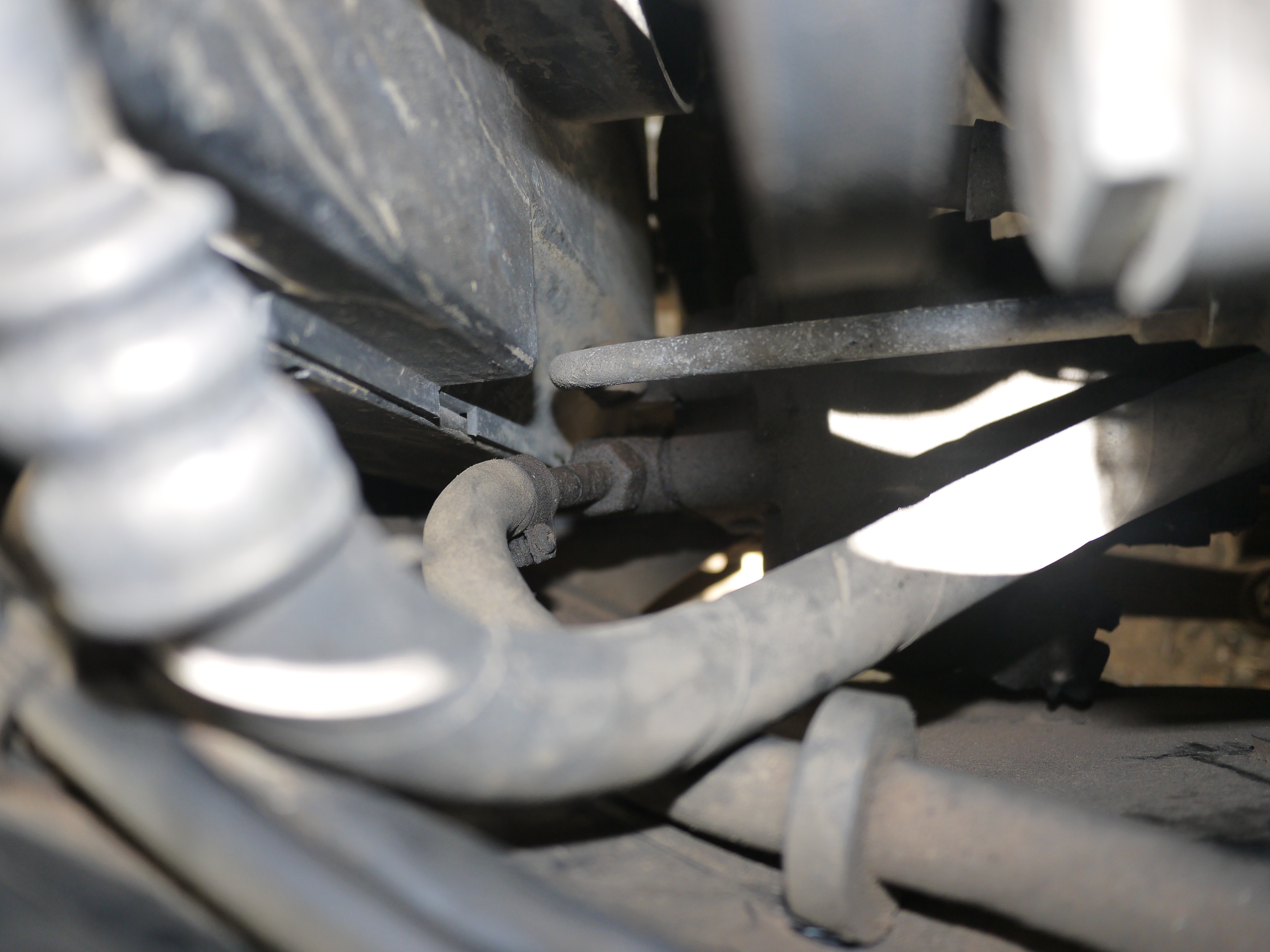

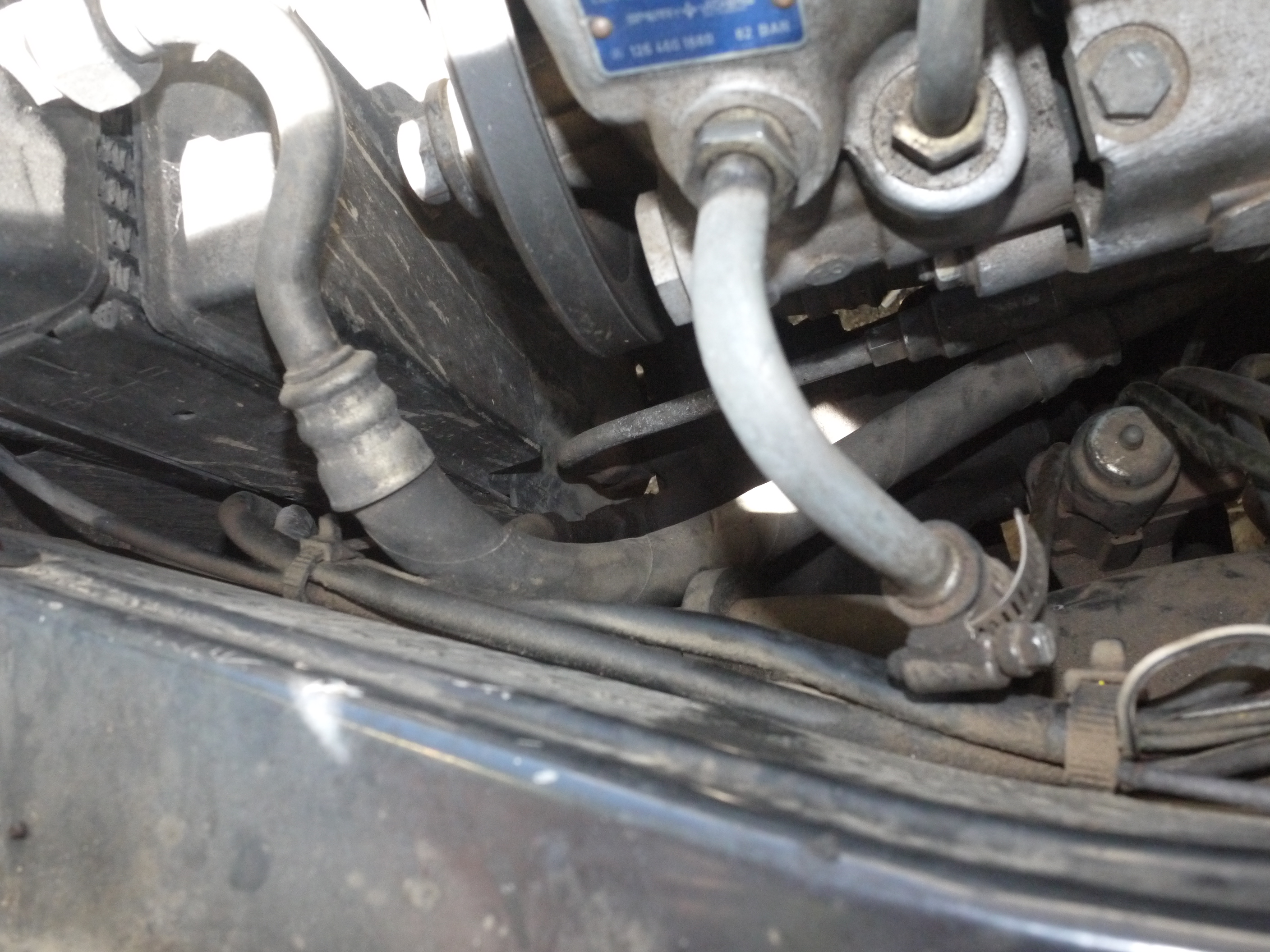

Here's some pics from a stock Gwagen that might be a great help!
- P1020384.JPG (3.13 MiB) Viewed 831 times
- P1020380.JPG (3.18 MiB) Viewed 831 times

Umm. That shows a low pressure pipe Into the bigger port and high pressure into the smaller one. So looks like I had it back to front. Thanks
