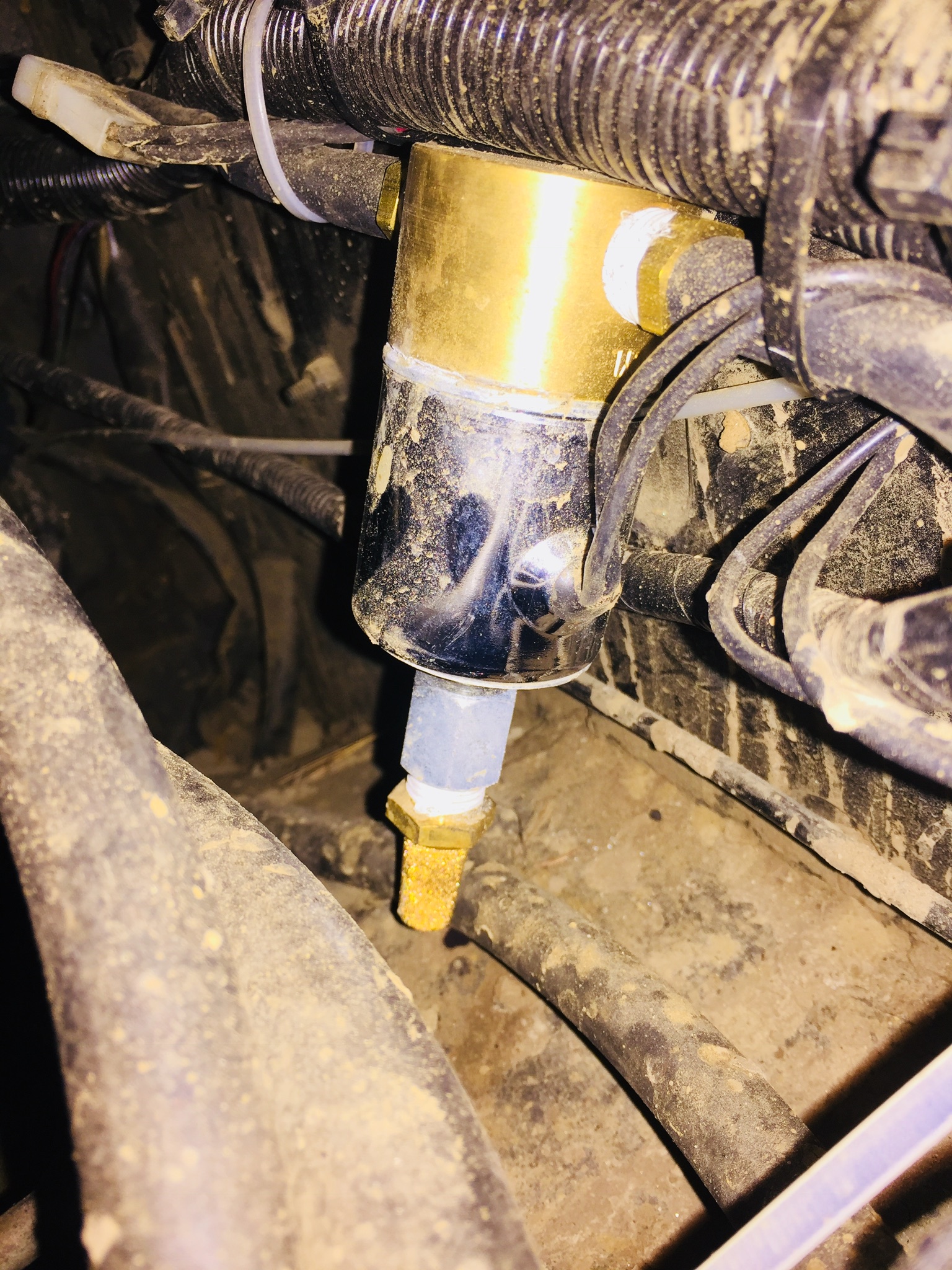

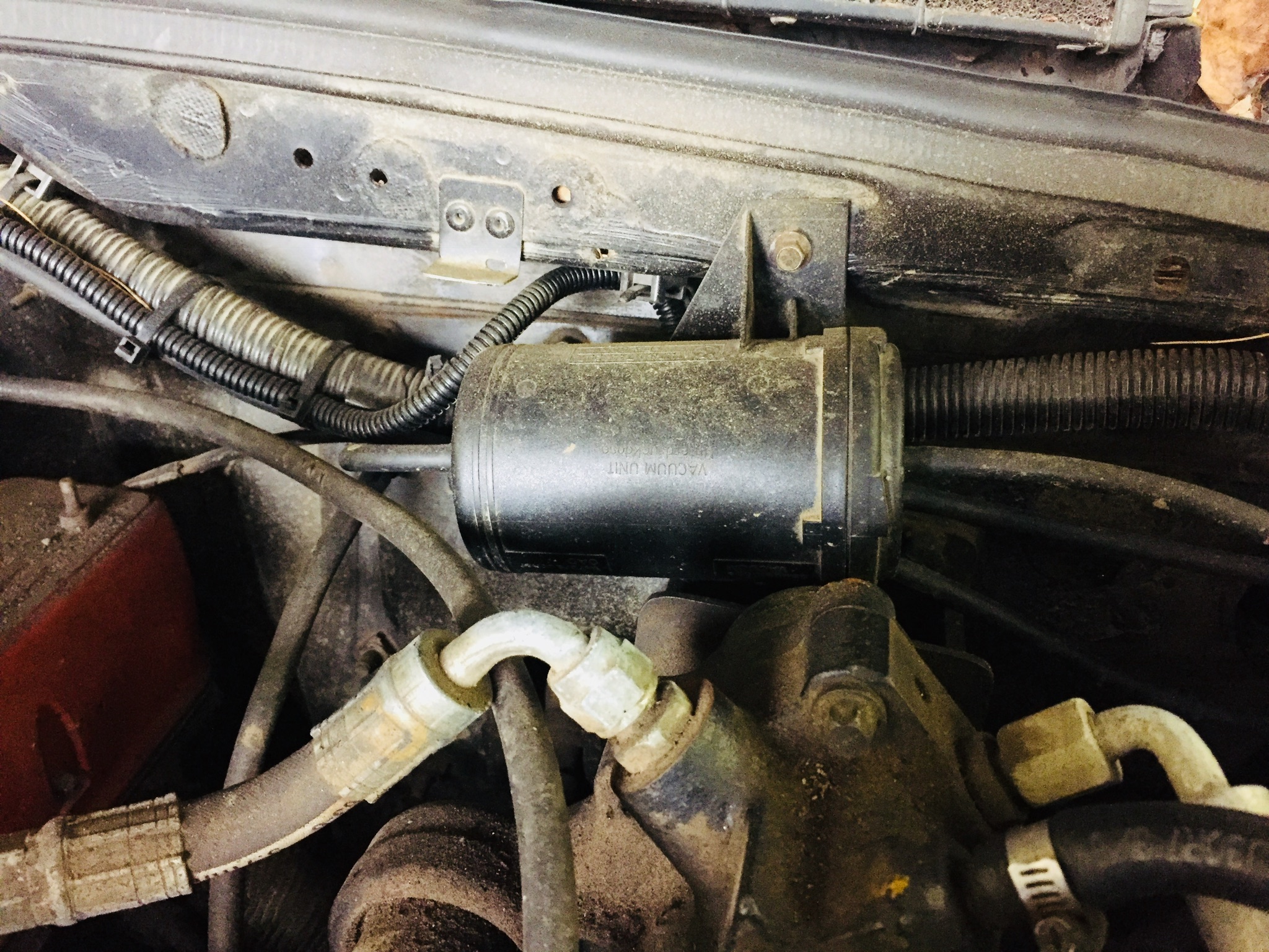

since I can’t reach them I’m thinking of going with an electric vacuum pump and a reservoir like a fellow on this board said but I would like to know what kind of reservoir he was using.. here is what i have for a set up..
It’s connected to the engine vacuum and I have a small reservoir from a disco2 Land Rover and a selonoid valve that’s activated from a switch inside .. sometimes it does not engage all the time and I think the vacuum could be the problem..

The only issue I see here is that the reservoir is way too small.
