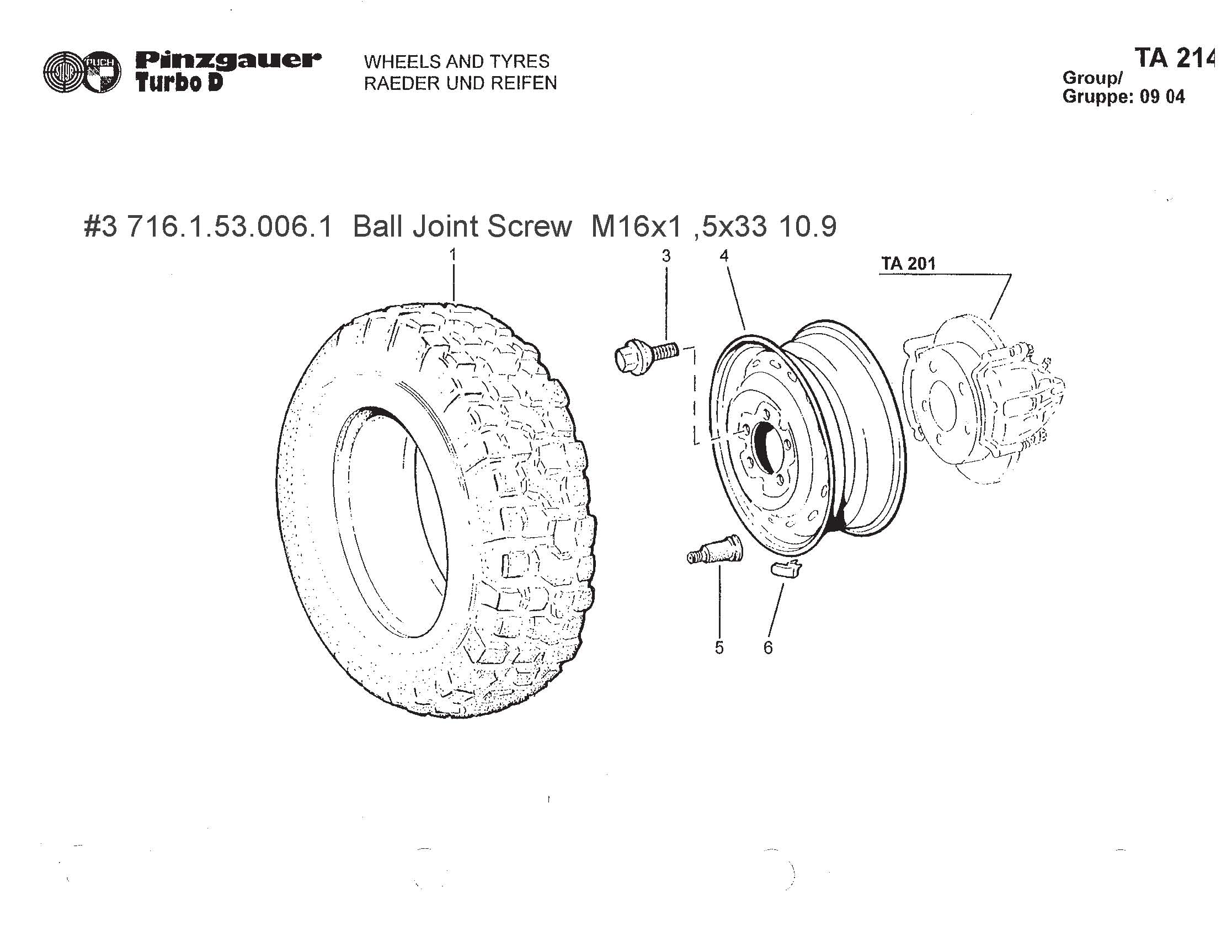

Re: Locking wheel nuts
Well the 710/712 uses nuts.....the 716/718 uses bolds
- David Dunn
- Posts: 2279
- Location: Arcadia, CA
As Joeri has said. TDs use a bolt, not a nut.
People need to be careful what they post in the sections. What may apply to a gas Pinz will probably not apply to TD, and vice versa.
- TA 214.jpg (197.75 KiB) Viewed 8549 times
