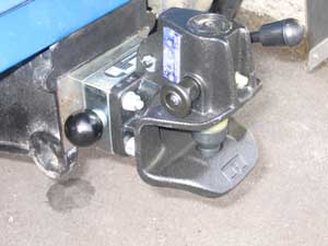

My Arborist just swing my and uses a Ball-Pintle combo hitch.
Kinda cool, don't know if there would be any interference with
the bottom of the door, but I found several options on etrailer.
Don't know about shipping outside the US either but knowing
something exists then the hunt begins
https://www.etrailer.com/dept-pg-Pintle ... Combo.aspx
