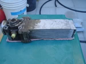

It is pretty much straight forward. There are shims on the bolts holding down the cooler and spacers under the cooler which you need to be mindfull of but other than that pretty simple. A good chance to clean the oil cooler while you are there. Recently had to clean mine, it was almost 80 percent plugged with mud.

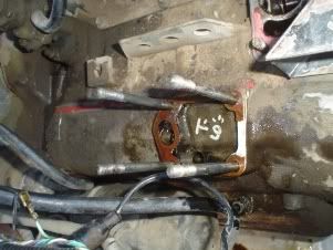

I was thinking and on some ocassions we see the fuel pump gasket leaking also. Might be worth a look before ordering parts. I know I hate the little leaks and seem to spend more time stopping them then any other items on the truck. I just hate those quarter size oil drips in the morning.

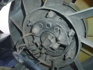

Parts arrived Thursday so I'm tearing into it today. I need to do a bit of R & R to that pesky molex connector too. This week my charging light started coming on at low RPMs. Road speed, no light... stop sign/red light, indicator light comes on. I hope it's just a weak connection at that molex. I know the belt is tight cuz I messed with that the last time I serviced it.

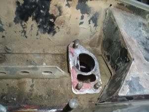

The wetness on the thermostat led me to suspect the cooler was leaking a bit. The filler pipe and dipstick tube areas were dry.
The mounting gasket seemed cracked just a little bit and tore away when I wiped it. SWPA Pres Mike was right on target with the idea of the fuel pump gasket. No reassembly until I get new gaskets for that.
All the wires and connections seemed clean and solid for the alternator. The suppressor condensor wire has been broken for quite some time so I don't think that's causing my charging light to come on. I do have a new one that I've just not installed yet, guess now is as good a time as any. Any ideas on the alternator? Should I pull it and have it checked out?

Great pics thanks. My leak seems to be coming from the fuel pump base too. I hope it's that and not the rear main seal or timing cover!PinzEOD wrote:![]()

I got some good advice from Scott at EI when I ordered up the fuel pump gasket kit (basically a rebuild kit). He advised me to put a meter on the alternator before tearing it out. If it's putting out proper voltage, my problem is probably the voltage regulator or wiring. Thank you Scott.
