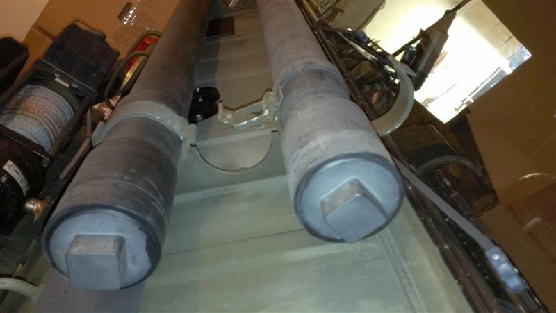

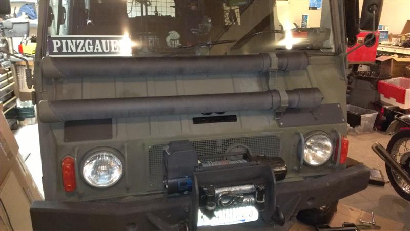

The set of pictures of the tubes on the front of my truck show tubes made from abs plumbing parts. Use your imagination, I used an inside fitting plug on the passenger side and a clean out fitting with a screw in plug for the driver’s side the raised piece just inboard of the driver’s side clamp is a coupled that I ground the inside ridge out of so it would slide over the main tube, I glued it in place just to insure that the tubes would not walk out of the mount. I scuffed the abs parts with sand paper to remove the gloss so they would look better on my truck.
I wish I could locate a set of the antennas cheap… fat chance of that happening.

Ed, that is very helpful. I have the whip aerials shown mounted on the white truck in your first photo. Since the come apart in the middle, to approximately the length of the front mounted tubes, I assumed those tubes were there to store them. Certainly it would suit me to use them for that.
I'll try the ABS route.
