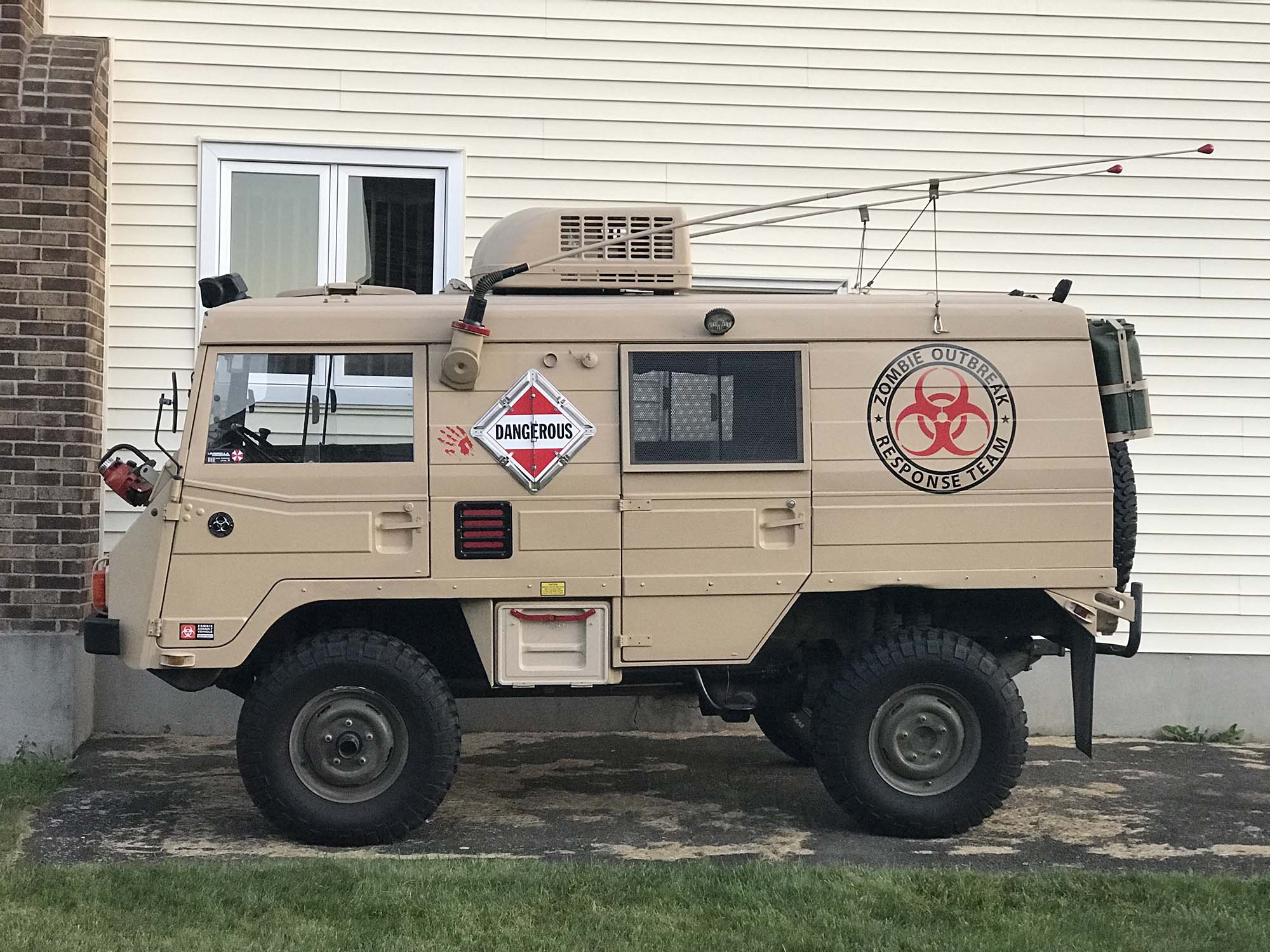

Thanks for the info and ideas!
Here there are installed now.... looks pretty good to me!
now on to the next project....

Post by whitesik »
That looks awesome! What antenna elements did you put on the bases and where did you get them? Are you using them or just restoring to original appearance? I am very impressed with the whole vehicle. Where are you located?

Post by AdamH »
I got these through a website: http://www.pvtjarhead.com
Pretty reasonable prices. Its the standard 2-part antennas that go with these bases.
I don't have them connected- I'm just using them for the aesthetics.
I'm located in Connecticut in the US.

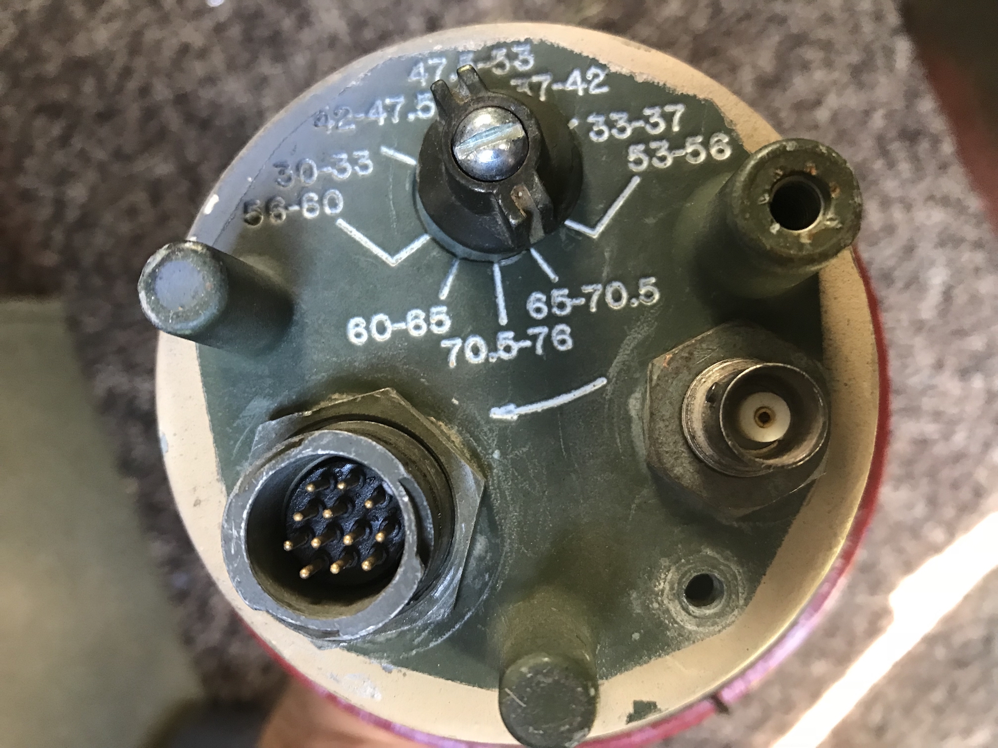

Here's a pic of the bottom if that's helpful.
