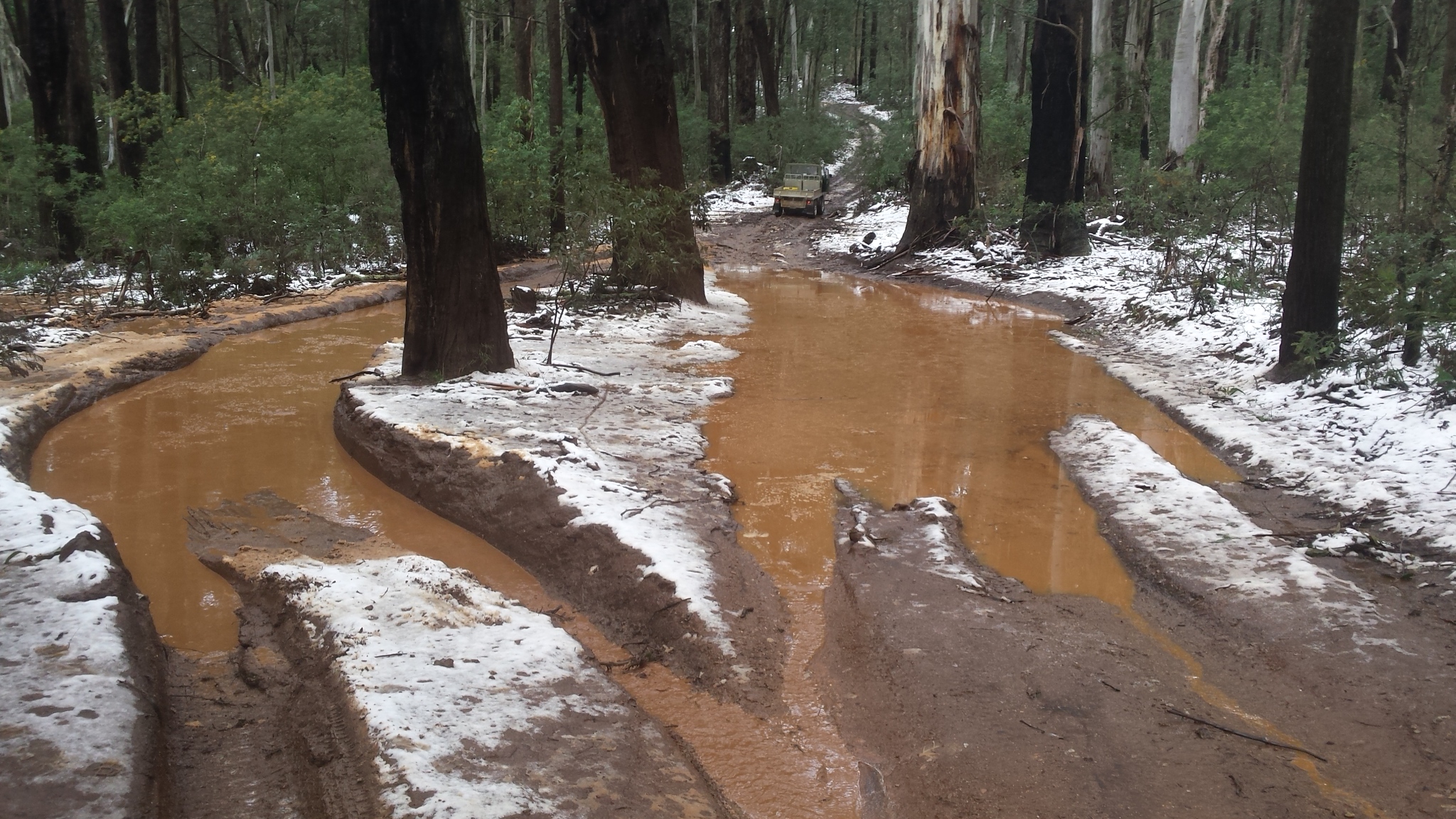

When you are going to be wading, then put the wading plug in - do it before you leave on a grip and take it out when you get back. However unless you were stopped in the deep muddy water I doubt you would get much crap in the bellhousing area with the wading plug not in.
Last year I waded this pool near home and spent some time stopped in the middle waiting for the wheels to gain traction before exiting was greatly relieved). The muddy water was well over wheels and came half way up the engine and I got nothing in my bell housing. My guess is that instead of getting a full dose of muddy water you got and little bit in there that has got on hot warm areas and the vapour" circulated around causing the issues you got - however of course if your vehicle sat in deep water or you managed to get an unlikey big squirt straight up the hole things might be different - but as the noise has gone as soon as the car gets hot I would say you just got a little bit.
I would continue to drive it and if you start getting similar noises in normal use then you will need to start looking further - it will most likely be the clutch withdrawal bearing and or the spigot bush.
Garry
