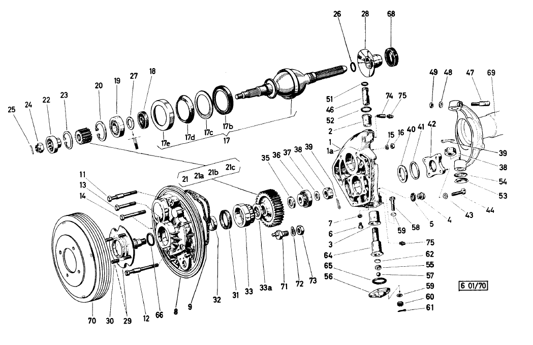

Whilst you have the whole hub apart, are you going to replace the oil seal sleeve on the flange shaft No: 66 & 32 in the picture? You can get that apart by applying heat the surface the oil seal runs on. When you get so hot it starts to smoke, it will suddenly "pop" as the rubber "O" ring inside expands and forces the sleeve to move.
Also a good idea to replace no: 68 (a strange double lip oil seal) - this it the one that leaks and dribbles differential oil all over the inside of your wheel. John
