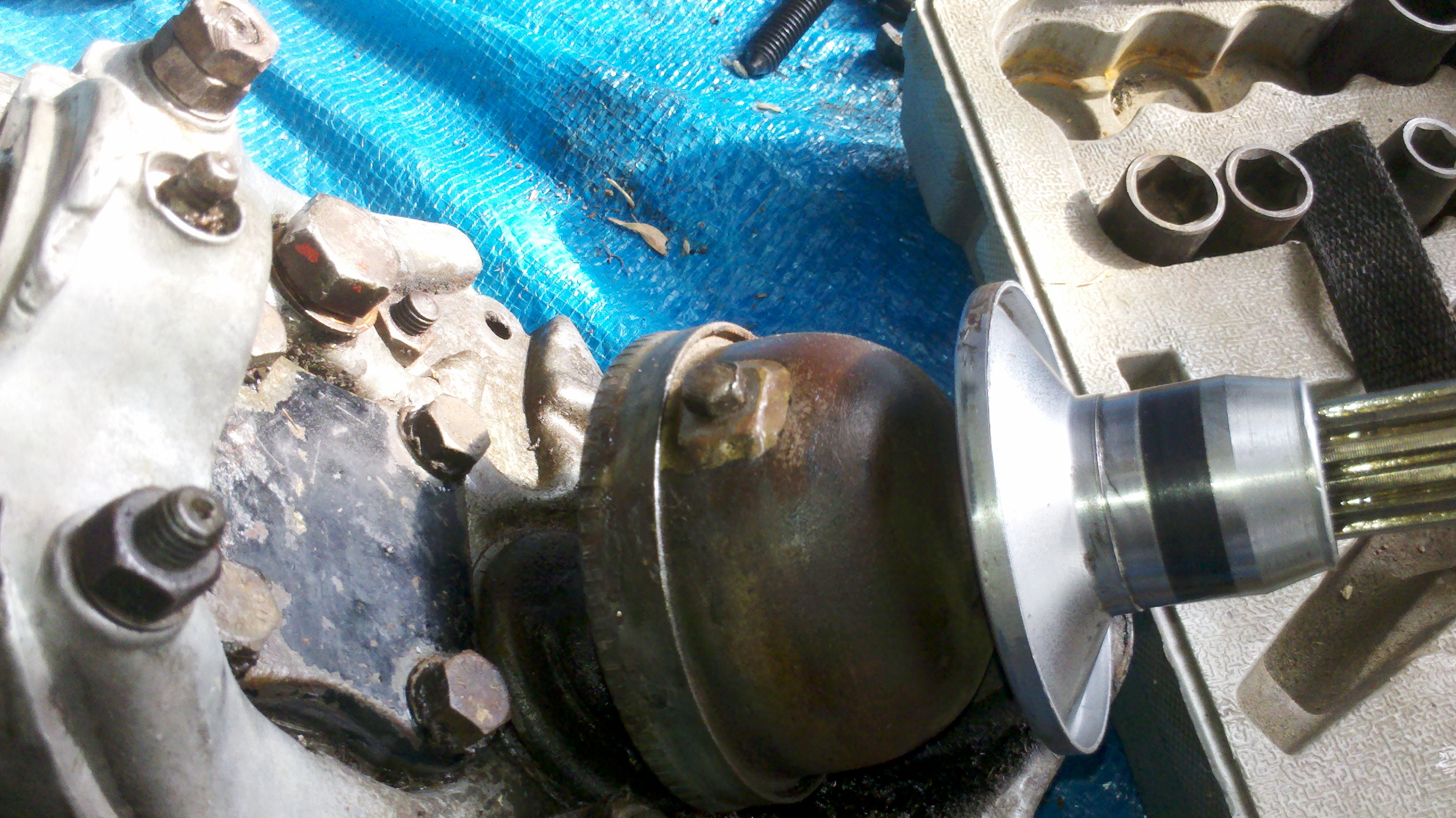

When I had my CVs out I drilled holes in them like this so new grease can be inserted without have to pull the front end out - tolerances are tight and the bolt cannot go inside the Cv but the bolt head needs to also clear the hub when the CV is rotating. There is no evidence my CVs are loosing grease so I have not service them in place.
Garry

And i did see your posts. I agree that the noise is too similar on both sides to be a coincidence, and is some what normal for the vehicle. Nice job on the modified CV!
