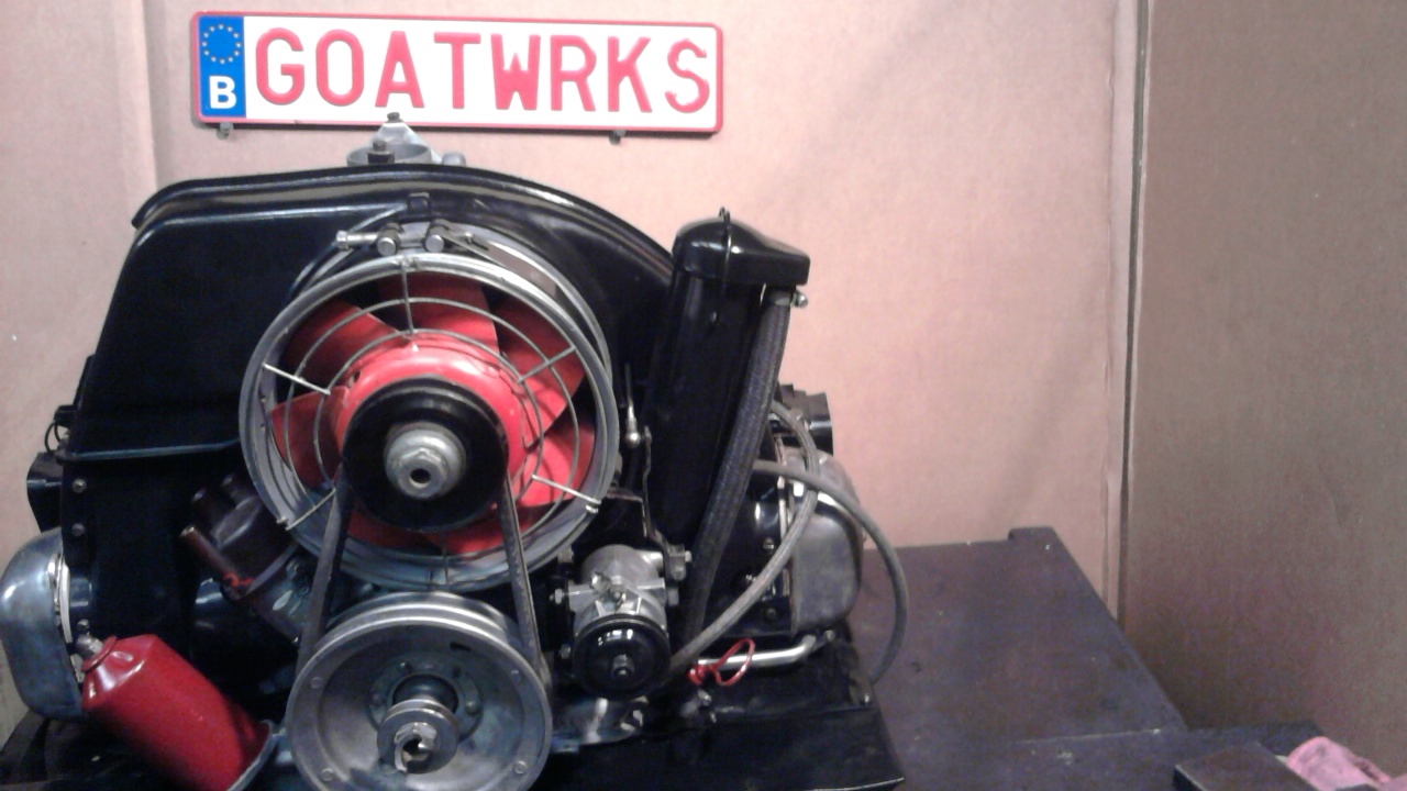

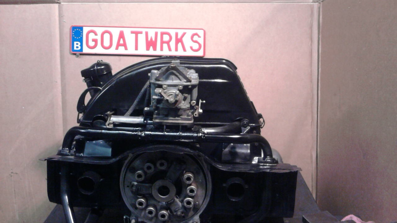

Guys, finished building Ricks new modded engine and thought I'd share a few pics.

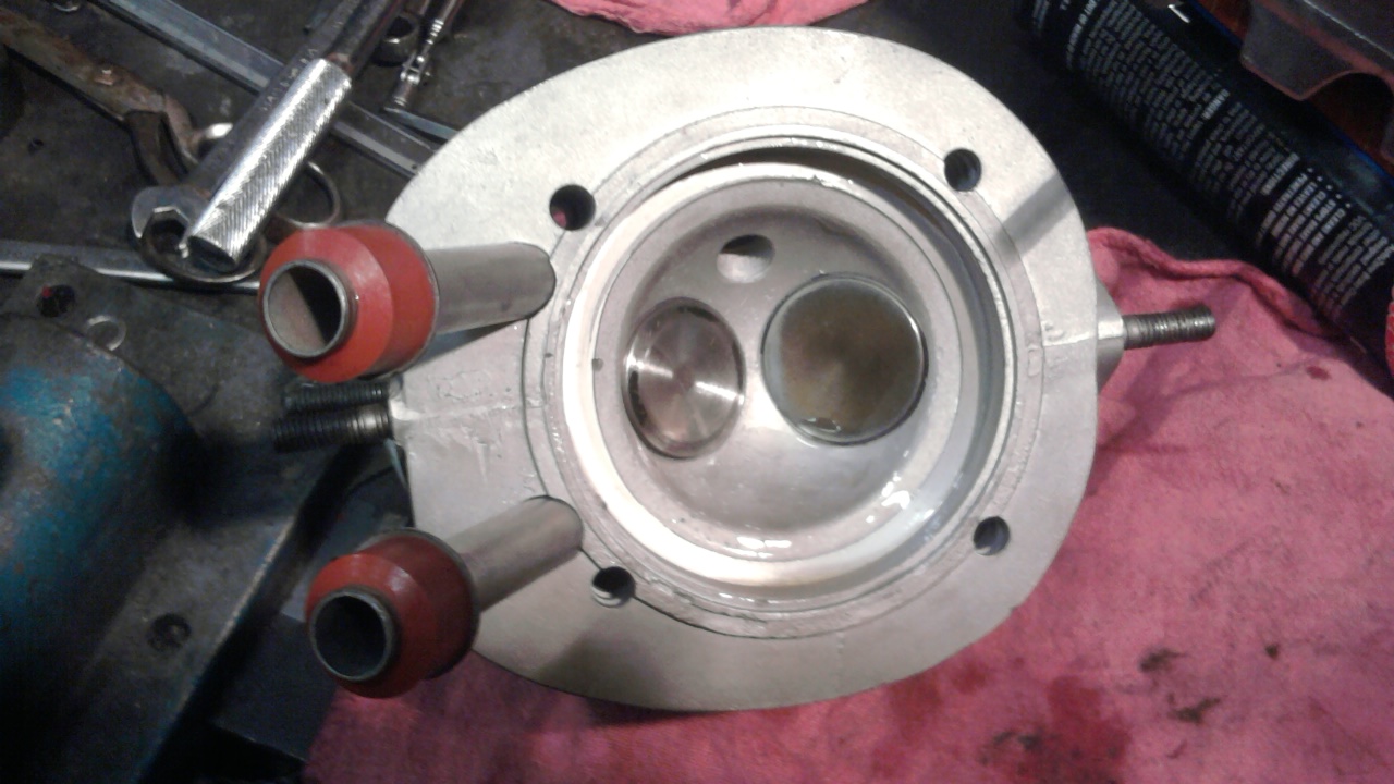

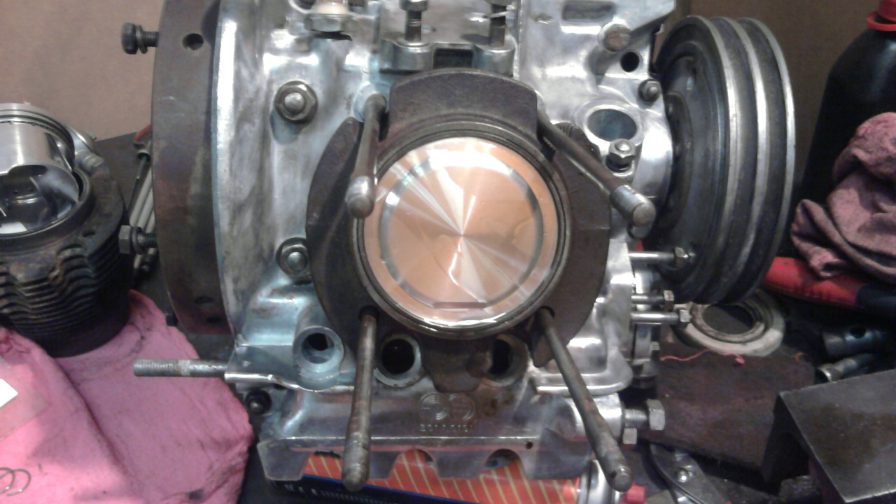

Greg, early engines had a 1 barrel carb with #3 cam.
This cam is great for top end power, but lacks in the low and mid-range rpms.
Going to the #5 cam you improve the power curve from idle to full out and with the forged pistons, the engine can operate well past the factory 4500rpm redline :twisted:

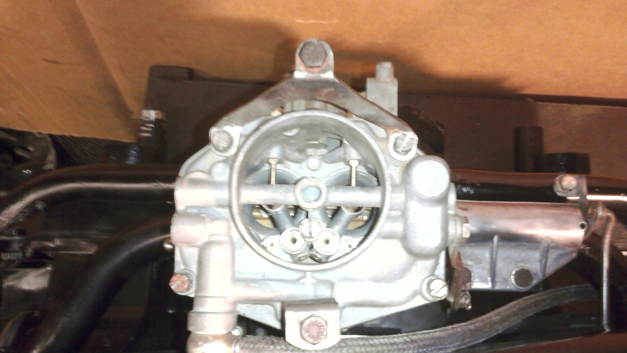

To make up for the extra few cc's , slightly higher compression pistons and decked heads, the carb has also been modded internally.
Venturies are upsized from 32-22 sleeves to 32-24mm sleeves to increase airflow , carbs are also re-jetted .
End result is at least 8-10hp gain.
