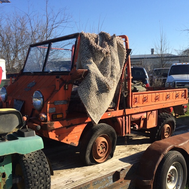

Considering buying a basket case I found
Moderator: TechMOGogy
- Posts: 18
- Joined: Fri Oct 11, 2013 7:55 am
- Location: Stockton CA
I own a 712 and have wanted a hafi for a long time. A buddy in TX just found this in a wrecking yard. I'm contemplating buying it even though it looks like it'll need EVERYTHING!!!!!
I know this is a vague question, but any idea what it would roughly cost to get this running?
$3k
$5k
Worth the effort?!
Thanks in advance!!!
Georg @ Valley Hybrids
$3k
$5k
Worth the effort?!
- image.jpg (166.68 KiB) Viewed 22645 times
75 "Warn" 712
A few land cruisers ......
Dodge mega cab tow-rig
Re: Considering buying a basket case I found
You purchased the Warn Pinz?
That looks like a Pathfnder model - snap it up and save it!!
As for getting it running - hard to say without knowing about tranny and driveline.
Looks like motor is missing?
- cascade.king
- Posts: 262
- Location: Vermont, USA
It's a Pathfinder.
Even if it's screwed up to the point of NOT saving it, any salvage value for usable parts might make it worth the purchase price.
Does the yard even know what this is? There have been wild price variations in basket-case Haflinger Pathfinders in the last 3 years. Something like $3000-$13000.

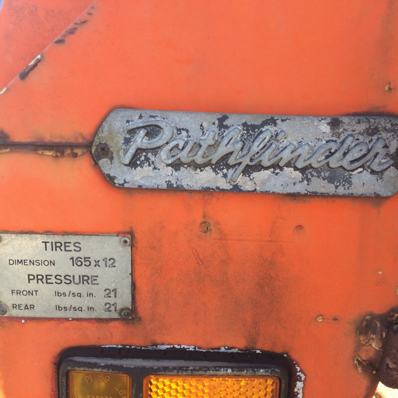

Here are more pics. The windshield frame is rotten thru, but I guess it's better than not having one. Engine and trans are there, but obviously need serious attention. I'm no expert by any means, but it looks like the main components are all there.
- image.jpg (186.31 KiB) Viewed 22533 times

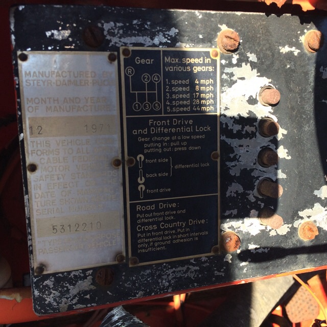

It does come with a TX title.
- image.jpg (148.58 KiB) Viewed 22533 times
- image.jpg (182.95 KiB) Viewed 22533 times
- image.jpg (165.66 KiB) Viewed 22533 times
- image.jpg (219.9 KiB) Viewed 22533 times
- image.jpg (191.7 KiB) Viewed 22533 times

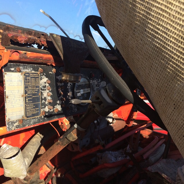

Last one showing rusted out windshield frame.
- image.jpg (160.76 KiB) Viewed 22533 times

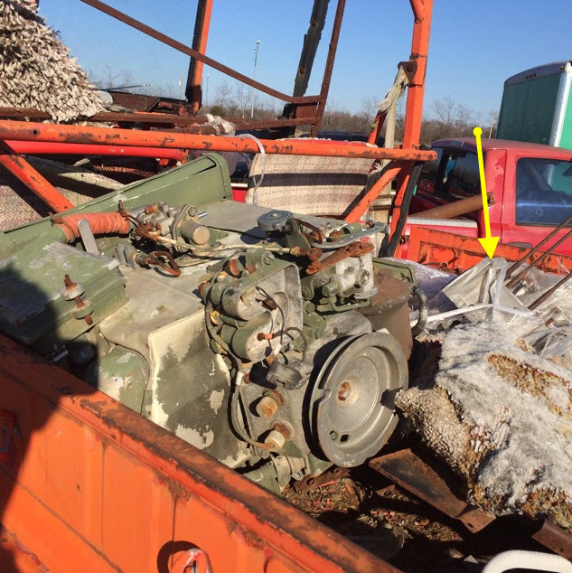

Well it looks fairly complete - most of the bits and pieces seem to be there but most seem either broken or fallen/taken apart
Good:
- Pathfinder model (will add to the Pathfinder Facebook page and up the count
by 1)
- Drive line seems intact
- engine block is visible (the other engine is not original and most likely will not fit)
- door frame(s)
- gas heater
- mirror stalks
- bumpers, stainless and rims seem ok
- rear seat frames
- nice rims
Bad:
- rest of engine, manifold, carb, dynastarter, etc?
- condition of driveline and tranny?
- missing rear view mirror and side mirrors (near impossible to locate)
- most indicator lights broken (harder to find these days)
- rust, rust, rust (you can see the windshield but you would need to look at the trouble areas like the front and rear footwells and the surrounding supports).
Most of the bad is just simple stuff like the lights - just depends if you want an original Pathfinder worth $15k when your done or a patched together run-about for the farm for $5k when your done (both assumes the engine is rebuildable and the tranny is good)
I guess - see what his price is and go from there!
motor:
The one in the foreground is not a Haflinger motor - yellow arrow shows part of Hafi engine block
Good:
- door frame(s)
- gas heater
- mirror stalks
- rear seat frames
- nice rims
Bad:
motor:
- 2-19-2015 11-59-44 AM.jpg (136.64 KiB) Viewed 22519 times

This Hafi "2210" built 12/71 came off the line just a few after mine ("2192")!Orangefj45 wrote:It does come with a TX title.
