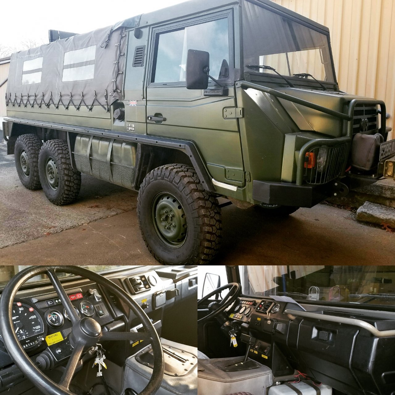

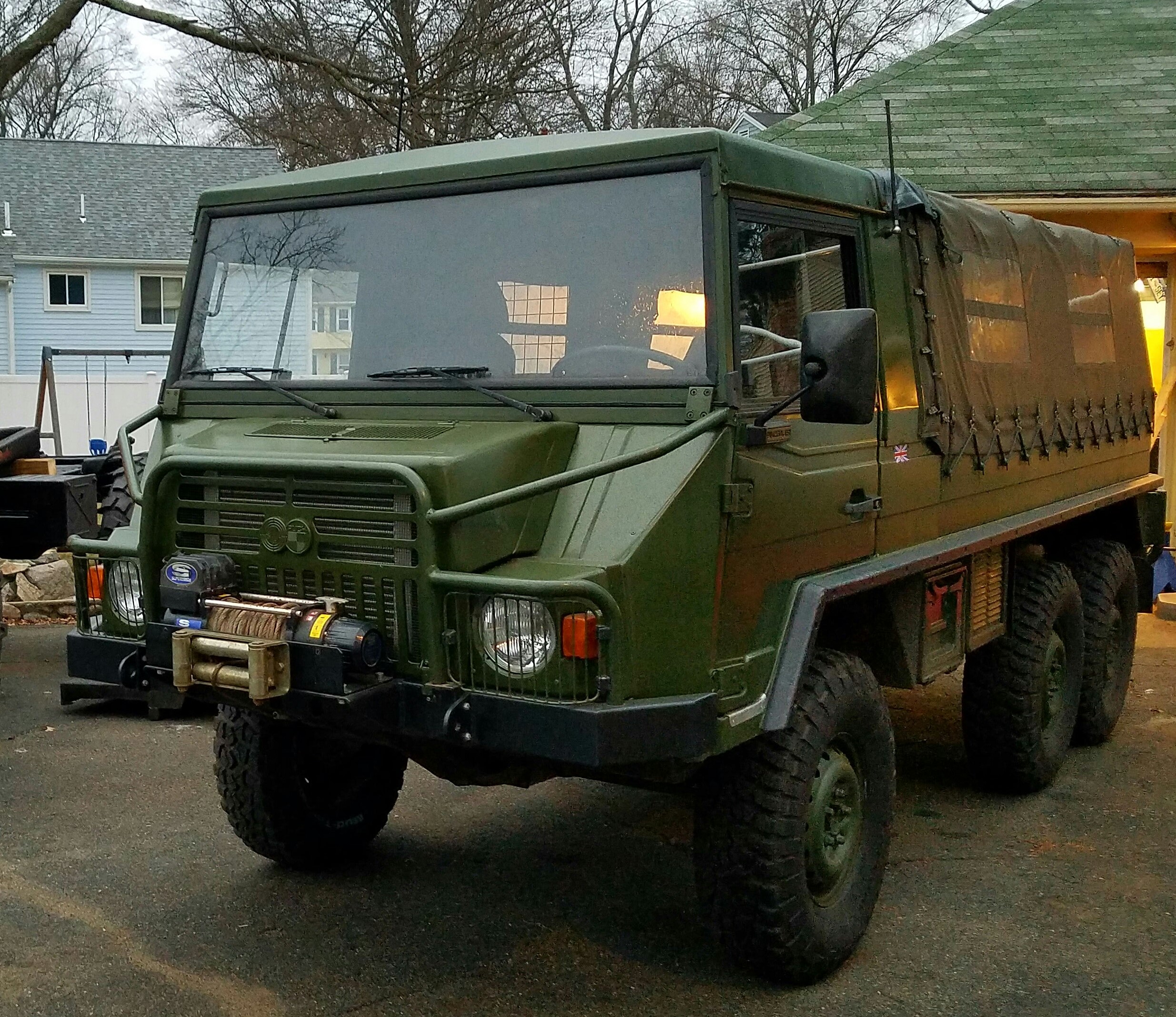

I've recently imported a 1988 718M LHD and she is in fantastic condition! with only 30k miles. I bought the truck with the intention to outfit and sell as an adventure ready rig capable of global travel. This is not a for sale add but will be my build thread. To share what I do and exchange ideas in the building and design process of setting this vehicle up. I'm very excited to get started on her but I do have a Unimog build going on simultaneously as well as keeping up with land cruiser parts orders and local work. So right now I'm in the design phase while sorting through the truck to get to baseline mechanically.
Here the truck is as she sat when removed from the container after her long journey. My face still hurts from the smile I had on the whole ride home.. She drives awesome. The 710's and 712's are tractors by comparison (and I love those too). These diesel variants are incredible. she cruised right along with traffic and the power steering with disc brakes makes driving a pleasure. Not to mention how quiet it is in the cabin compared to all the petrol versions I've been in. I love it!
