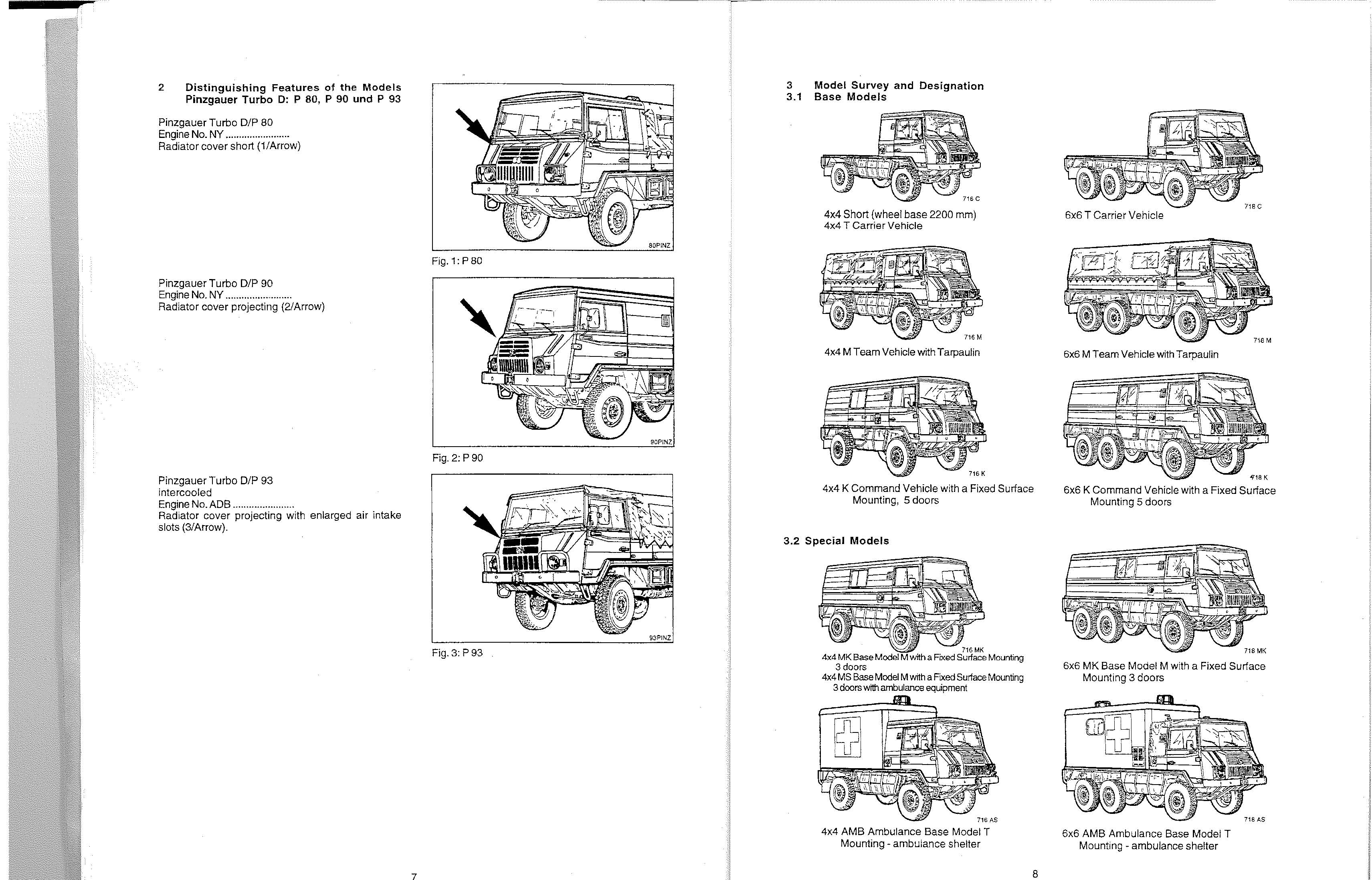

The diagram below illustrates the radiator cover difference from the P80 through the P93
- TD designations.jpg (873.21 KiB) Viewed 3332 times

Do you think that the last version of the P90 is also the same package as the P93 except without the intercooler? Or is the P93 a whole different version in itself, a version 5?
