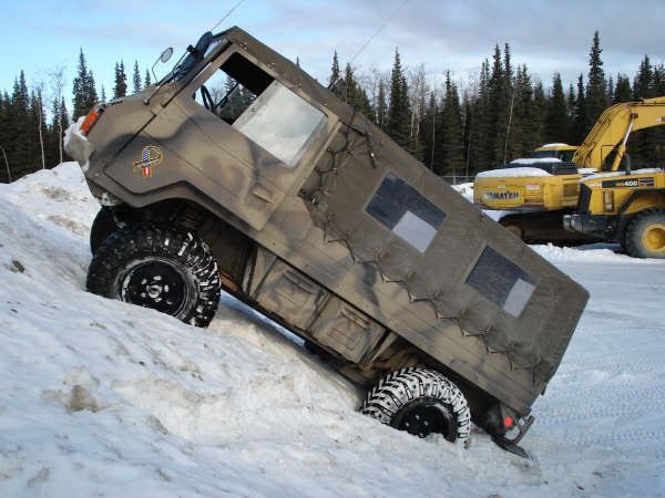

THANX TO MY SON WHILE I'VE BEEN AT WORK HE GOT THESE ON. FEW MINOR MODS WITHOUT NEEDING TO GET LONGER STUD BOLTS.....SINCE I COULD NOT FIND THEM. SIZE 35X13.5X16 ON 10 WIDE WHEELS
true design wheels in Denver http://www.truedesignwheel.com/index.html
i did not want to trash my original wheels so they made a flat center , then had to make spacer for behind that. well that only left me 4 turns of the nut on stud
they said it would be enough but I was not comfortable with that.
i tried to locate longer studs with no luck. so i had the spacers machined down a little (here in Alaska) and with different lug nuts my son got it to work but not ideal.......if i was to do it again i would have original centers put in or locate different wheels that fit like original.
i am new at the pinzgauer world and was on time crunch to get wheels before i left Denver area to get vehicle north. previous owner had these tires on original 6-1/2 " wheels. tire manufacter recommended 10-12 wheels for these so i wanted them switched before i left to save shipping costs on custom wheels.

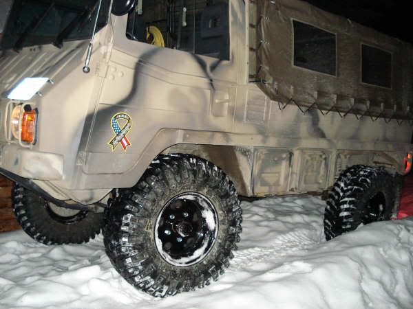

picture to show difference between original size and new tires

pix above shows compairison of new tires with 245x75x16
i really like the looks of the new wheels as well.
