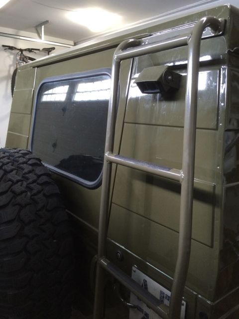

I'm sorry I haven't been back to contribute to this thread. Good install in the Pinz! I like how it looks on the dash. (You gonna trim those ears off that mount, I hope?)
I LOVE the magnet idea, too. Wish I had thought of it before drilling holes in my truck. Does it move around on the bumps? Yes, the camera power leads are short, they're only meant to reach the back up lights.
Re: Backup Camera choices.
Hi Donny,sixbennetts wrote:I'm sorry I haven't been back to contribute to this thread. Good install in the Pinz! I like how it looks on the dash. (You gonna trim those ears off that mount, I hope?)
The magnet holds the camera rock solid, no movement at all. It is really stuck on there even though there is a plastic film on the bottom. The camera is oriented to just have the spare tire edge in the bottom of the frame (can't see the hitch for example) and it works well for backing. The beauty of the magnet is that if I was trying to line up the hitch to a trailer or on some other mission, the camera could be easily repositioned to stick it lower where the hitch was visible.
I was going to experiment with some .75" coated neodymium magnets (much smaller thinner, slightly less than a quarter sized) to see if it would adhere well enough on the 2nd camera that arrived last week. I thought of maybe jb-welding two magnets to the mount but to see if they would have the "pull" of the current one (early experiments say not).
As far as the ears on the screen mount, they were the potential mount point for four of the .75" neo magnets. But if I keep the big magnet as-is I will dremel the ears off. I think the screen will end up being attached to the roof between the visors once find a clean way to run wires.
The last step is probably to paint the final form mount and camera OD so it blends in a bit better.
Thanks for the great find and idea, Donny!

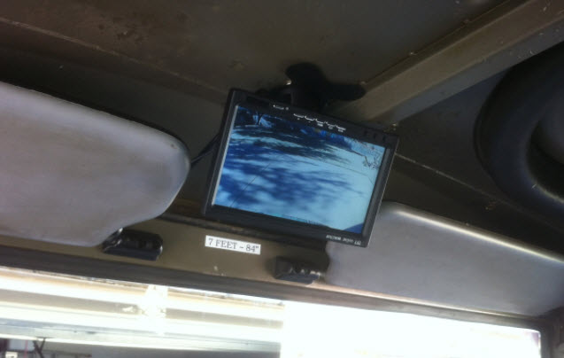

For the Pinz the screen fits well on the roof between visors, more out of the way, can be folded up, and does not stick out as badly. Used 4 neodymium magnets with adhesive on the base. Might cut of the ears after I'm sure I don't want them - they help to peel the base off the roof since it sticks with quite a bit of force.
I'll probably leave it here.
Haven't figured out where the spare camera is going to go, but the #2 video input could be used for anything.

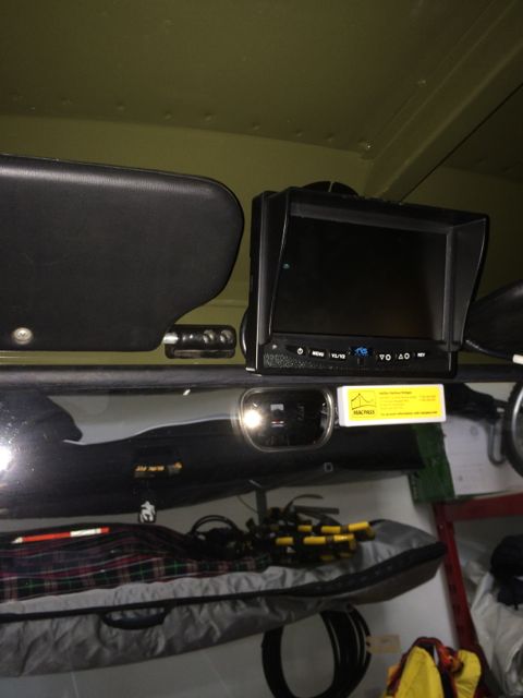

- Posts: 198
- Joined: Thu Dec 01, 2011 7:15 pm
- Location: Plattsburgh, NY
Yup, that's exactly where I'll be moving ours to if I ever get a tablet for the dash. It'll bump the backup monitor up to where you have it.

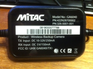

For those interested in the GPS option:
After eyeballing my backup camera, my wife decided "I wanna backup camera too..." as she can't see out of her SUV either. Santa brought her a Magellan that a GPS with a wireless camera option. This is the same camera I tried to get an answer out of their tech support several months ago as to whether it would run on 24V to no avail.
The Magellan RoadMate 9055-LM and a Magellan CPBCKUSGXXX Wireless Back Up Camera could also be a workable option. The camera and inline transmitter runs on 10-32V [like the signal from backup lights]. The GPS and the piggyback wireless receiver runs on 12V (most of you have 12V somehow in the cab). I put it in her car over the weekend but it would work fine in a Pinz. The one rub is that whenever the camera is powered, it takes over the GPS screen, so you can't really leave it run all the time.
This particular GPS is a huge 7" (seems huge to me). The back-up camera video display must be about 10-15 frames per sec. Works fine for the intended purpose but its not the smooth video as from a the sixbennetts-style unit. This GPS runs about $180 and the camera around $130, so quite a bit more expensive.
