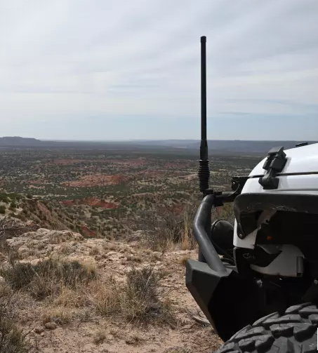

Saw these new antennas for "rugged use". That look pretty cool to me and it comes at a good time since I started looking for one recently!
https://midlandusa.com/pages/ride-the-r ... alId=VTURT
GMRS guru review: https://www.youtube.com/watch?v=IGPUT3WgFto
New GMRS antennas for 4x4s from Midland

Curious what you think Ron (and other Hams) of the ground plane issues/SWR of the bumper mounting. Any Australian guys here that use the bumper mount that's popular there?
Re: New GMRS antennas for 4x4s from Midland
GMRS is just over 462 MhZ. A wavelength of about 67 CM.
All you really need w.r.t. a ground plane is 1/4 wavelegnth
so your down to less than a foot for a decent "ground/radial".
So if you ground near a bumper it's going to be good.

I was also thinking of the position overall. On a forward cab a bumper mounted antenna has lots of metal up one side of it. Never did an SWR test on a setup like that so wondering how that would affect it.
