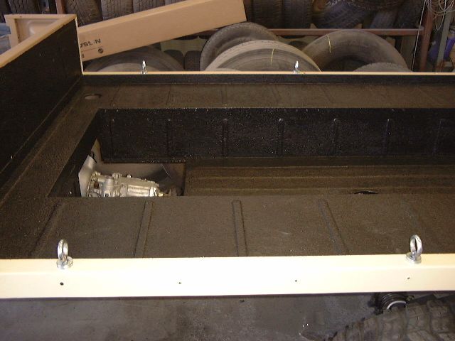

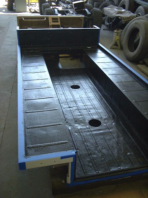

Well the roll-on liner took 5hrs to apply from start to finish.
I first prepared the surface by scuffing and wiping down with acetone.
Taped off the edges and applied the first coat.
After 3 coats.
After 5 coats and tape removed.
A closer shot shows that you can roll the liner on and not clog up the screw holes.
I used 2 gallons of roll on liner from Walmart, and got 5 layers applied. It rolled on easy and built up into a uniform pattern. It was easy to control the material and did not clog up the screw holes, thou it may be possible to do so if you are not careful.
All in all, after the finish dried for 24 hours, I was very happy with it. How long will it last, only time will tell, but I feel that it will hold up to reasonable abuse.

Looks real good Miles. I found I had to move the transmission cover holes do to the lining thickness. Does yours still fit bolt down?
