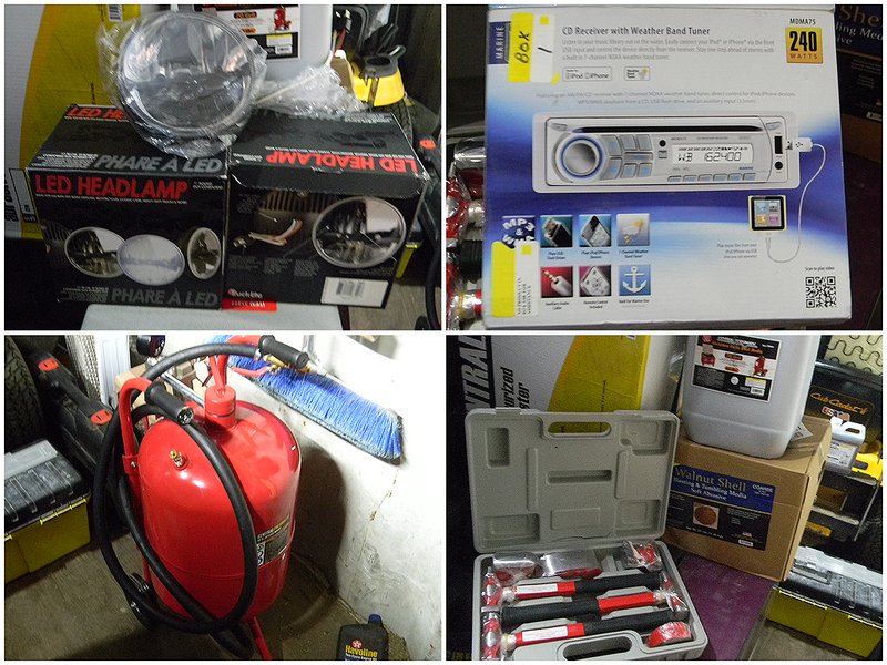

This shows the new LED headlights, the new marine stereo deck, the new 110lb. pressurized sandblasting unit, new body panel tool set, walnut and aluminum oxide blasting medium

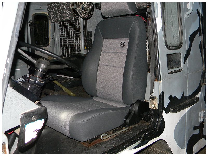

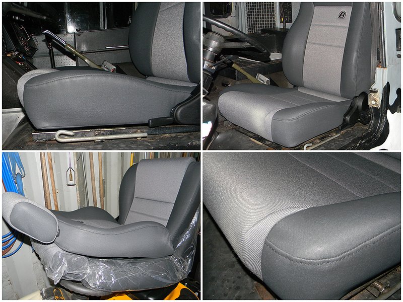

This is a couple of shots of the new seats. They are Bestop Trailmax Pro II suspension recliners in oiled canvas w/ heavy denim inserts. They fit really nice and are about 5" high on the sides, though the center of the seat is almost the same height as the stock seats.
The fit and height of these is really a nice fit. They are not mounted yet, but I will be using the old seat rails and doing a bit of welding on them to fit, so add another 3/4" to the height. The seats (thankfully) have 3 different sets of mounting holes to choose from. I got them from Amazon for about 274$ each.

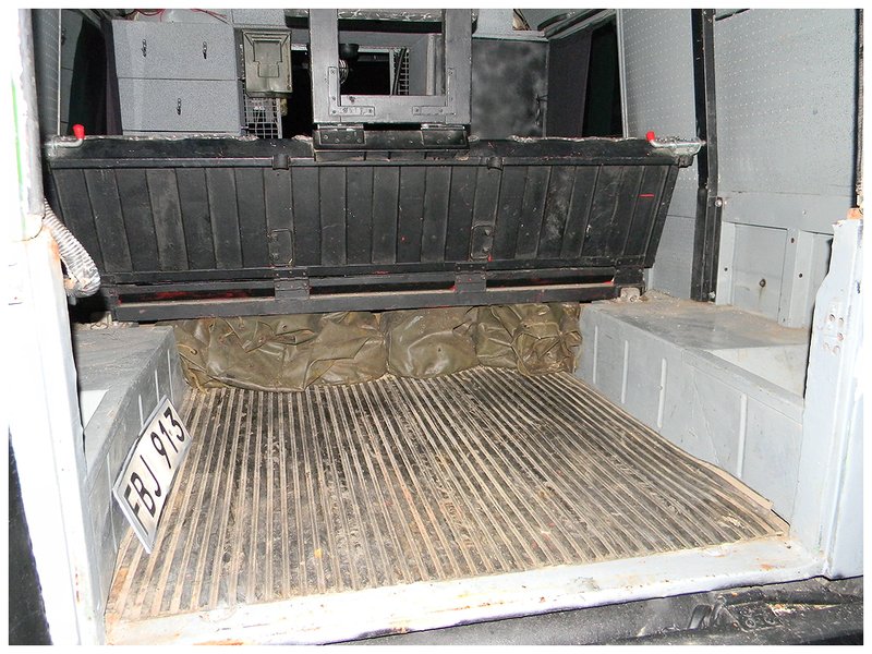

Here is the back inside. I have removed some nasty old plywood shelves and supports, wire side shelves. You can see the original license plate from Norway also. The 4 bags under the bench seat are the heavy duty tire chains.

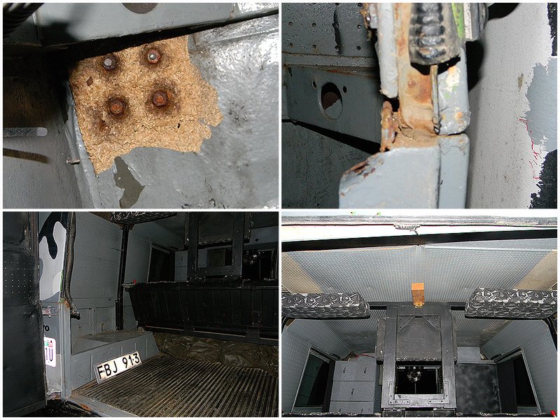

Top left: The remains of the awesome particle board antenna mount. Its literally just crumbled away to almost nothing, though the steel behind it is in decent shape. Top Right: right side of back door frame, showing where the top panel meets the tub, rusted at the seam but only on the corner for the most part. The tub itself was replaced a few years ago and is in really nice shape. Two bottom pics show the general condition of the interior pegboard panels, which are all warped and need to come out. I will use them for making patterns for the new ones.

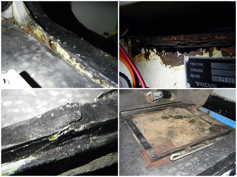

These pics show the worst damage. Top Left: hole inside the drivers door channel up near the hip. Top Right: Worst spot on the truck is this hole under the base of the small window behind the drivers door, where the top and cabin meet. Bottom Left: The drivers side door channel in the cabin is really in bad shape, needs to be cut out and replaced with decent steel. Bottom Right: The seat bracket bottom, showing the years of greasy dirt thats caked under them. Oyveh! Need some degreaser there.

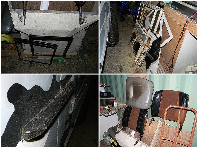

Some various parts: seat brackets out and waiting for the welds and an extra doghouse cover, extra set of old doors, some obvious rust, but still a source for bits, the old seats are in rough shape, as well as the external bump rails, which I will replace with black PVC square rails.
