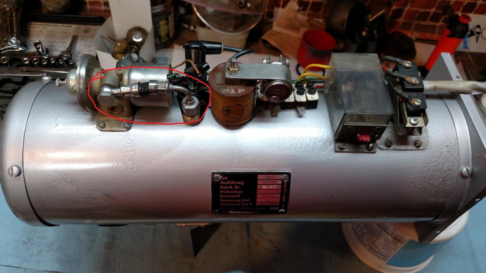

Did you ever solve the smoke problem? I am dealing with it now. Don't know how to adjust the mixture if it is possible.

I suspect the dosage pump may not be operating correctly.

Re: Gas Heater fuel adjustment
Post by dadnova »
Mine put out black smoke I adjusted the screw, from your picture on the far left, turn it out if possible. I reduces the spring tension on the diaphragm. Mine went from black to clean, but my screw was all the way in?? That way when I bought the Rig.
