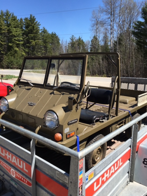

I just did it a month ago - you need the 6x12 trailer.
The way they designed the rear ramp/rear of the trailer you have 1" on each side going in.
Once in you have lots of room and they have good tie down rings on the floor.
The others are to small due to the high sides
The car hauler works (did that one last year) but the ramps are wide and only 1/2 the tire is on it - bit scary so I did the 6x12 to make it simple
Here is pic in the 6x12

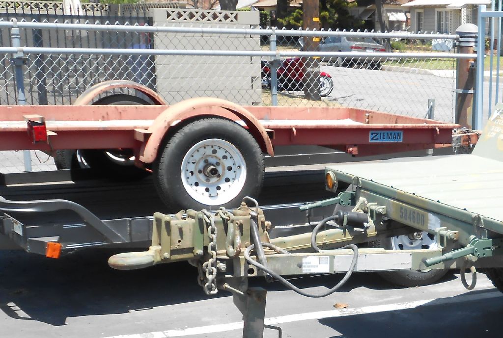

Since then I have had several different utility trailers , for 5x8 , 5x10 and my current favorite a old Zieman 5x10 tilt bed ( Jim would love to get his hands on )
The Zieman is super light and I pulled it a few times with a Mighty Mite on it behind a Highlander Hybrid
Shown nested in my 83" x 14' hauler

I was looking to see if I had any pics of the Haf in the Dodge ( been so long ago, and a few computers back), but these are of it with the Zieman.
