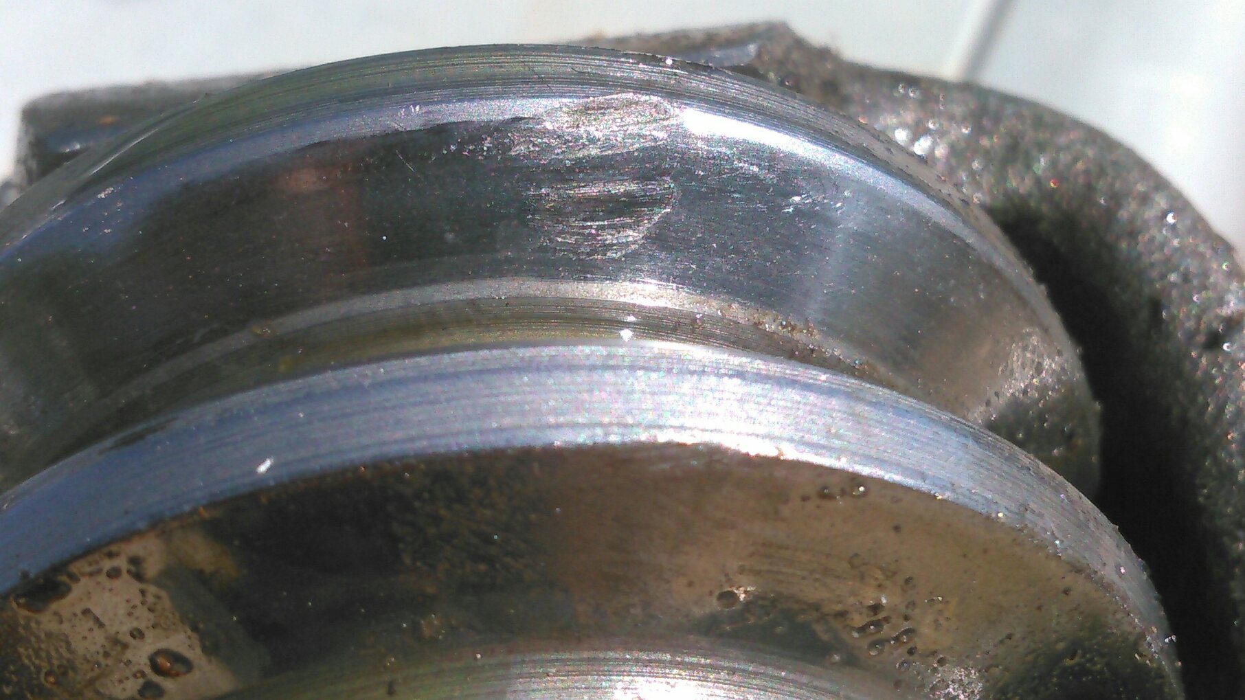

excellent. Can you share the issue you found?
- Posts: 436
- Location: Vallejo, CA
Re: A big thanks to Expedition Imports (Scott)
Turned out to be a frozen (nearly frozen) sector shaft gear in the steering box.
Thru the process we got some new data points on the electric power steering.
#1 - You need to have a good/excellent steering gearbox to start with. If not, rebuild prior to installing the steering system.

If I were to do this upgrade again I would just factor in the cost of the rebuild kit. Not all that expensive and it would insure proper operation. I had no idea there was an issue with my steering box until we took it apart. Thank goodness Scott had the parts in stock when we were there.

My steering could not be adjusted anymore, so i decided to go for a full refurbishment.
once I took it apart i knew why
I also replaced the bronze bushings and the ball point bearings. The bottom one is easy, but the upper one requires a special tool.
I had this done at a ZF shop.
runs like new now, and steering is a kids play now

Yup, same thing happened to mine (see the tech section).
this is what we found in the steering box.
