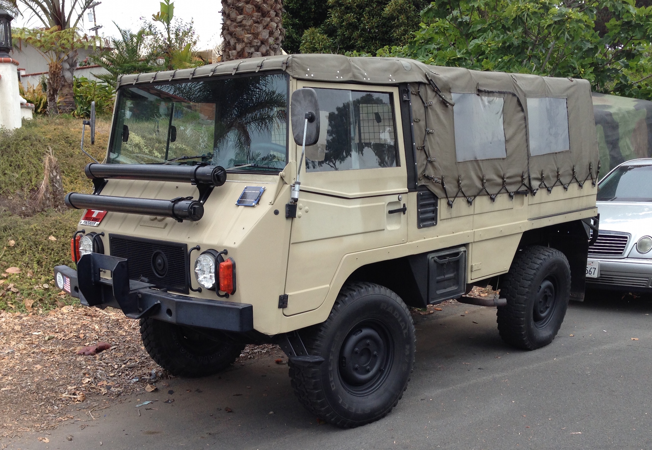

Re: Using the Harbor Freight Solar panel to charge pinz?
City trucks, ambulances and the like hide them on top. Since my 710k is all canvas, I found a spot on the front of the nose, port side, just under the windscreen. You can find my "build" and images here viewtopic.php?f=14&t=6456&p=46003#p46003.
GADS! This was way back in July 2011. So, this thing has been on for almost 6 years.... same batteries.
Another upgrade I highly recommend is to replace the starter. The new one is way lighter and has much more torque. https://expedition-imports.com/PZGRST
- my pinz .jpg (1.19 MiB) Viewed 3935 times
