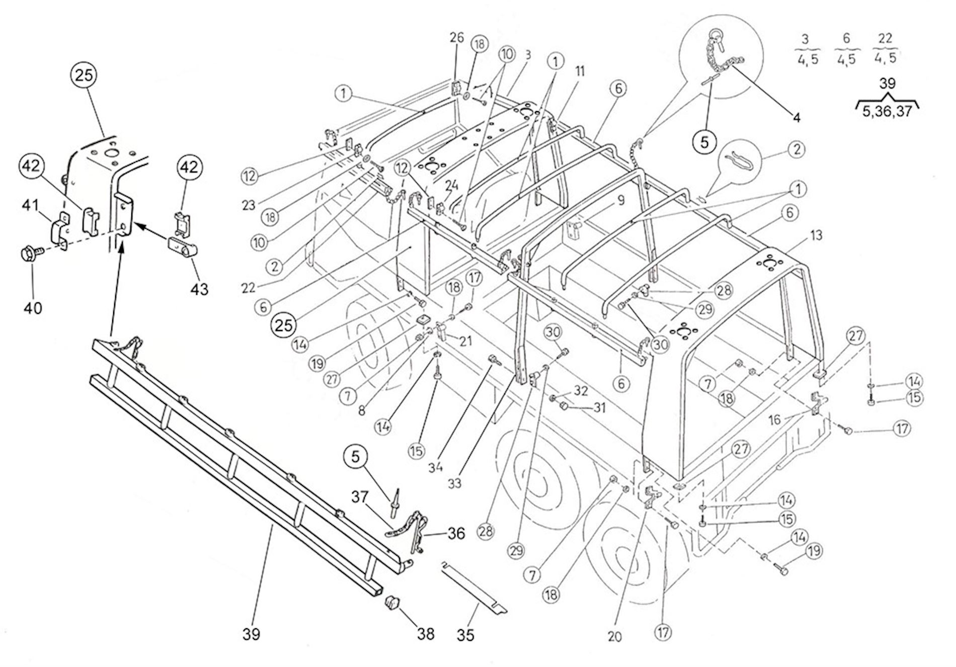

Incidentally, puch.at is a good source for parts drawings -- see attached of roll member.
It's actually a "bow" not a tube construction. They are far sturdier than they look, item #25 in attached.

rmel wrote: Mon Dec 13, 2021 5:20 pm Incidentally, puch.at is a good source for parts drawings -- see attached of roll member.
Very interesting rmel, it appears the front roll member echoes the back one. So they positioned two bows together and wrapped sheet around them to create fore and aft rigidity. This explains to me why you see a half-window between the cockpit and rear windows in Joeri's photo of the silver car above.
