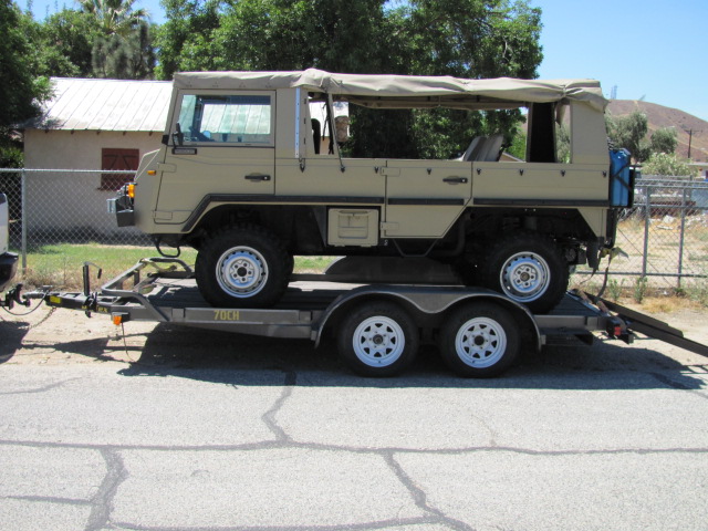

I uses to haul my 716 on a 14' trailer, just need to have it balanced for the proper tongue weight.

Re: would you tow a 712 in a dump trailer?
Dave,
That was my concern with the 14 ft dump trailer, getting to much tongue weight forward and not being able to back it up a bit.

Depends on the trailer but yes, backing on and trying to place engine weight over the axles would be best IMHOSonarman wrote:Dave,
The 716 is 8" longer than 710, and would more than likely need to be back a bit further, BUT it come down to where the axles are located.
Utility trailers have the axles positioned for normal loads having a good tongue weight. You'd need to check the specs on the dump trailer you're looking at to see what that manufacturer deems the "best" location. Best is to "try" the trailer and see where the Pinz may set best for good tongue weight with a tongue scale.. don't load the trailer without hooked to a truck, or the trailer will take off, then disconnect and jack the trailer up and put the scale under the trailer hitch, and adjust the Pinz as needed to get the proper weight on the tongue (>10%, < 15%). A bit of a pain to do, but makes for easier towing experience, and a knowledgeable one. I have lines on my trailer for each different vehicle
