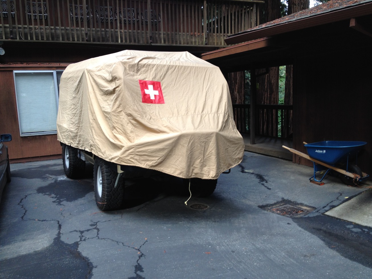

R A I N !! Time to move Mozo under wraps. An alternative to
the garage too low to get her in :( :)
Had this made by a guy who does Boat and Aircraft covers.
Oh! The Swiss cross was done later to fix over eager Mice
that eat a hole in the cover while in summer storage -- a
never ending battle of Mouse and man up in the hills.

That's a pretty nice looking cover, I think the end result of the conversation is an 83" door will not fit a pinz no matter what is done short of major changes...
