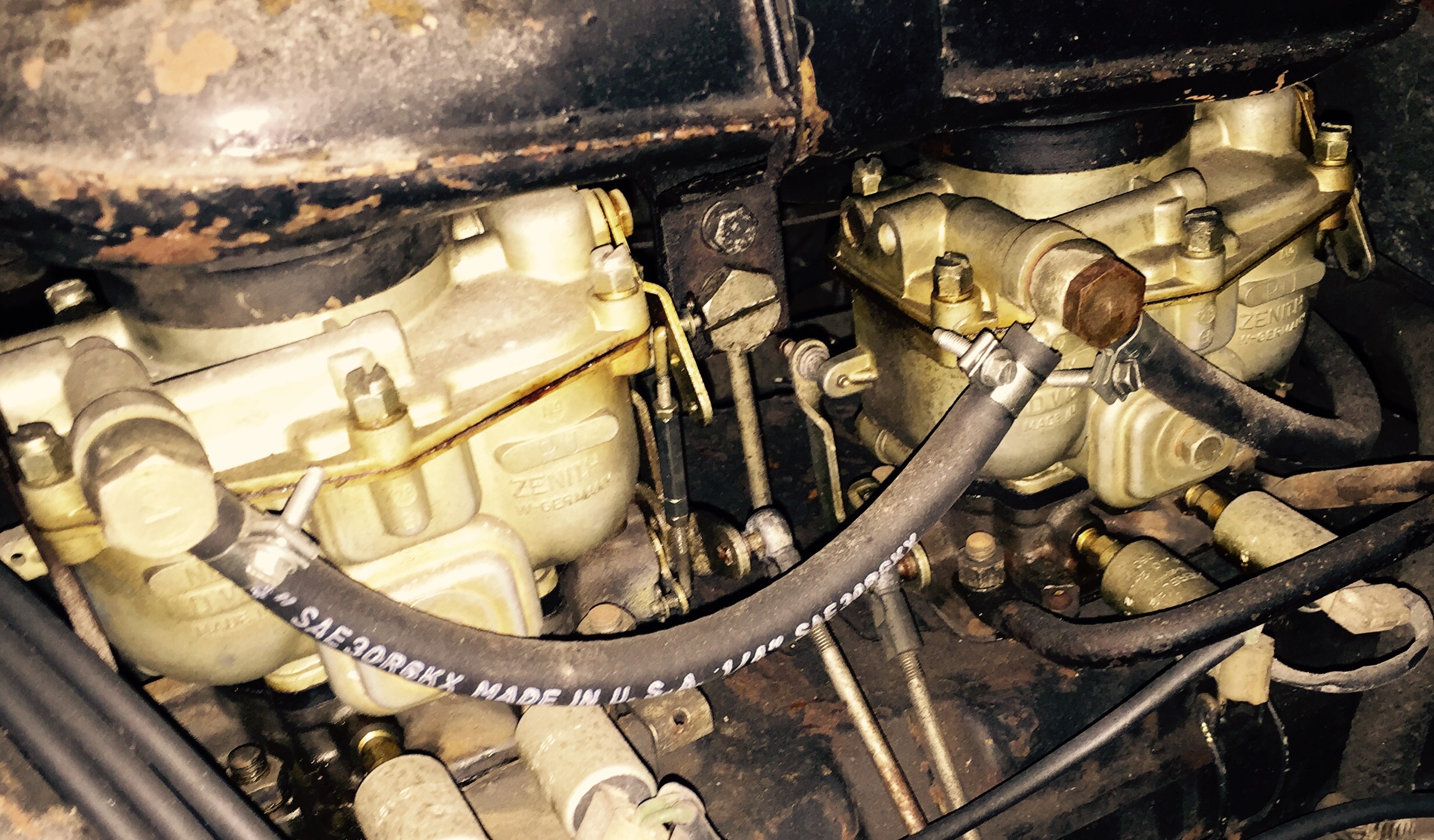

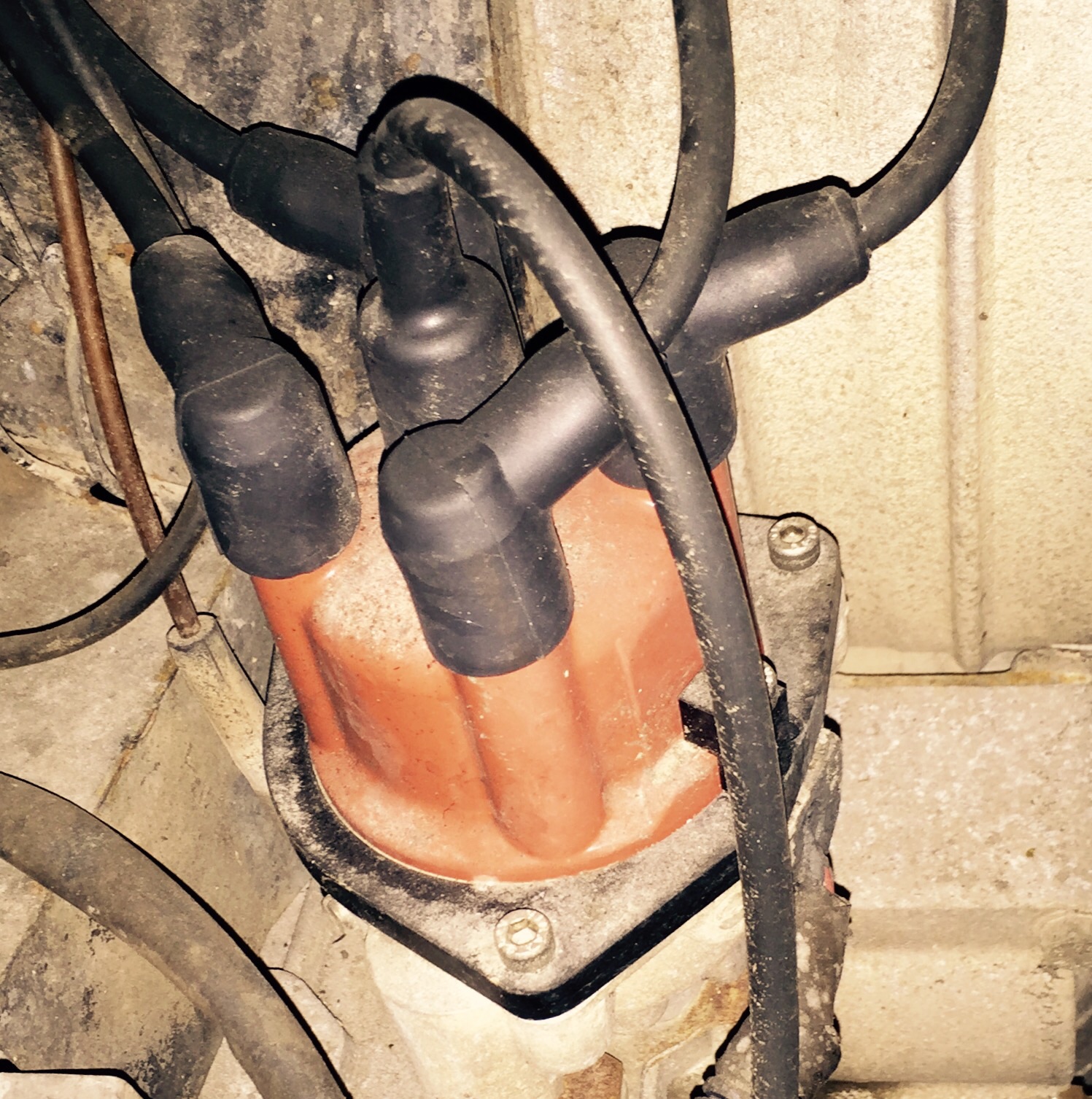

The carbs and ignition coil appear to have been replaced. Can anyone confirm this and provide more details on the parts?(I'm working from my phone and believe I have uploaded the images correctly)

Welcome! First gear is for steep inclines only, or for going very slow. You can easily start rolling in second gear. No asbestos in the wind tunnel. What you have there is a thin foam-type material that breaks up to clog your air filter and cooling fins. Remove it. It was placed there to minimize noise. Many owners have changed to civilian ignition systems to lessen cost. Yours is one of them. The carbs look standard to me. Good luck.
