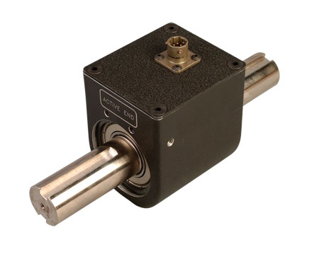

How about this: a torque sensor to put between the transmission and transfer case. You would have to baby it except in 4th gear but once you got to fourth you could measure engine torque. http://www.omega.com/pptst/TQ513.html
Jim Chance
710M
Re: Dyno dreaming
JimmyC wrote:How about this: a torque sensor to put between the transmission and transfer case. You would have to baby it except in 4th gear but once you got to fourth you could measure engine torque. http://www.omega.com/pptst/TQ513.html
Yeah, and it's only 2 grand. You guys must have a lot more $$ than I do. :shock:
