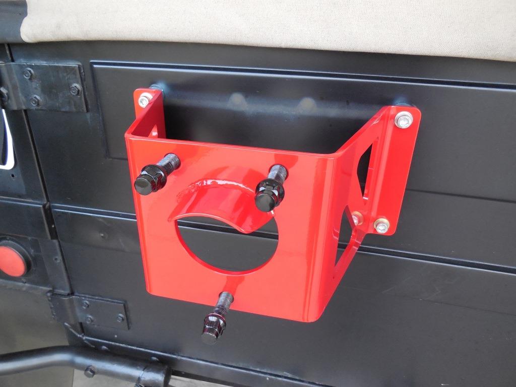

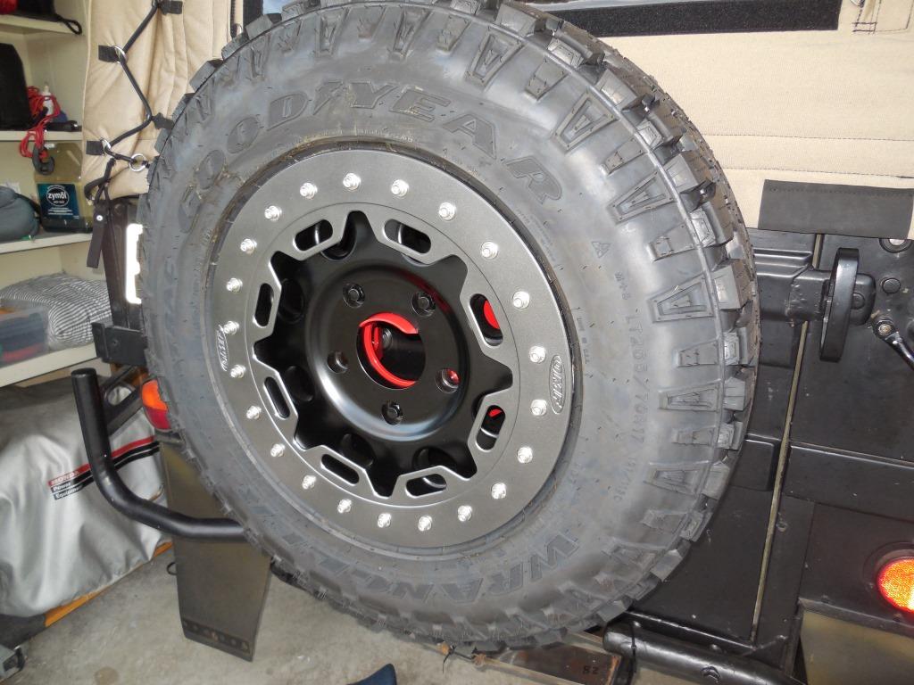

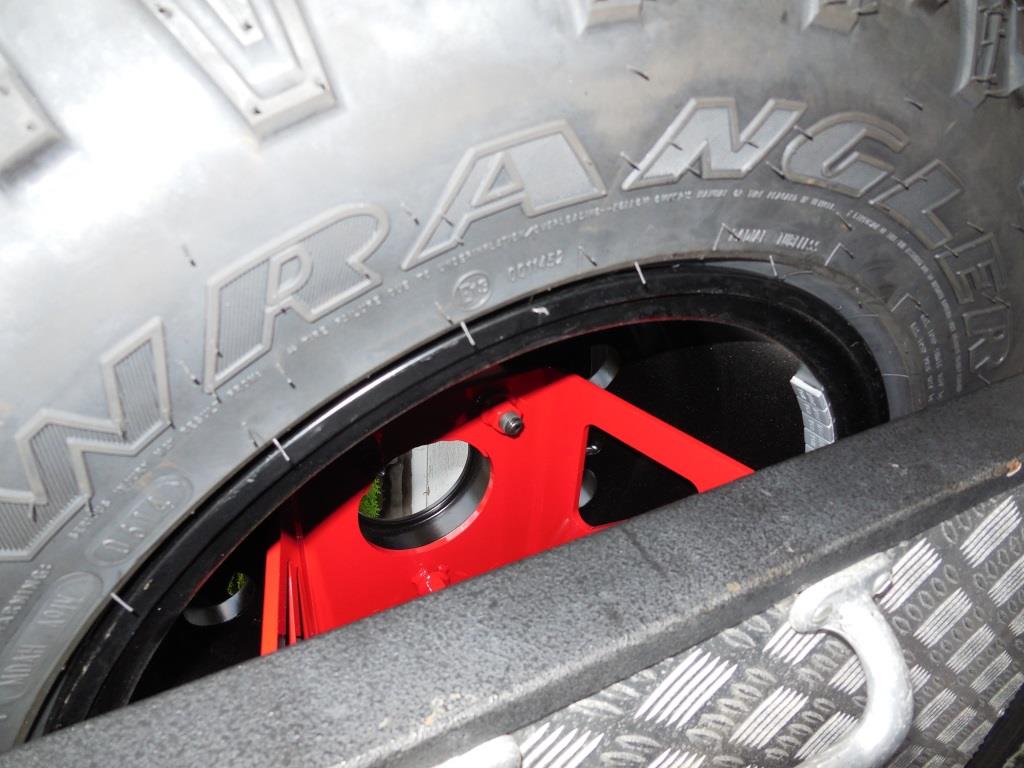

Here is another way of doing it. Not better or worse, just different. Studs are security type with a matching driver head to prevent theft.
Unit is bright red for visibility while changing tire on highway (besides, I had a batch red to go to powder-coat and I'm cheap)

Nice wheels.
Where did you find them?

Nice solution for a hangar. I like the little tongue thing. It should
stick out just past the lug nuts, like on the original. I found the
original tongue was very helpful so you could lift the wheel into
place and not worry about lining up the holes with the lungs until
it was resting on the tongue. If there was one addition to Andre's
design that I would add, it would be that tongue, like on the original.

Re: Spare Tre Hangar - Reverse wheel position
If it's the same truck, he sold the wheels recently. So I'd guess they're aftermarket wheels, with beadlock rings. ??

Thanks all. The tongue was necessary because the "studs" are actually bolts not studs, so the wheel can be lifted and just sit there while one bolts it up with the special security driver socket. I have hurt my back several times trying the "thread the needle" while holding up a >100lb wheel on my Landcruisers. About the wheels, they are the GT Pinz wheels 17 x 8.5 with OMF rings. I was able to weld the mounting rings on easily without stripping the paint. Then, bolted up the beauty rings that were painted anthracite color. (fake bead locks...street legal that way). To those that are asking about making some of the tire holders, send me a PM and I'll see if there is enough interest for a short run. If Andre has a laser and a brake, I'll send the flat layout to him gratis.
