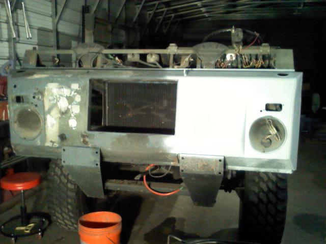

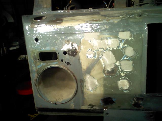

More progress pics.

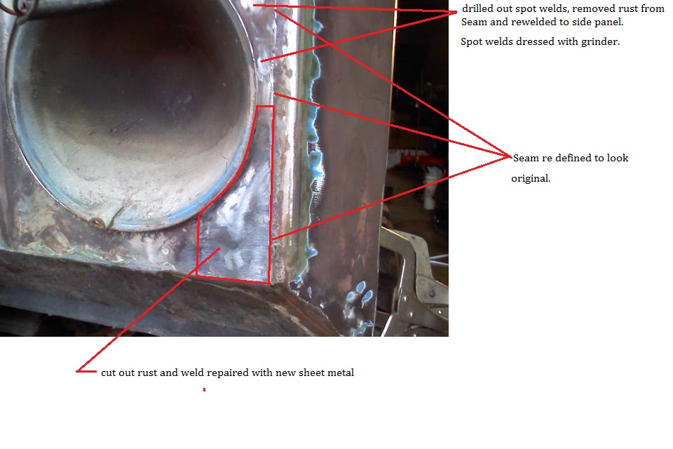

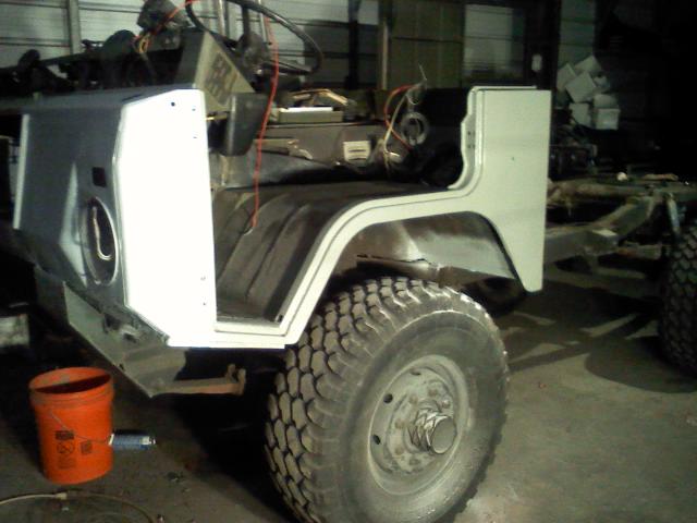

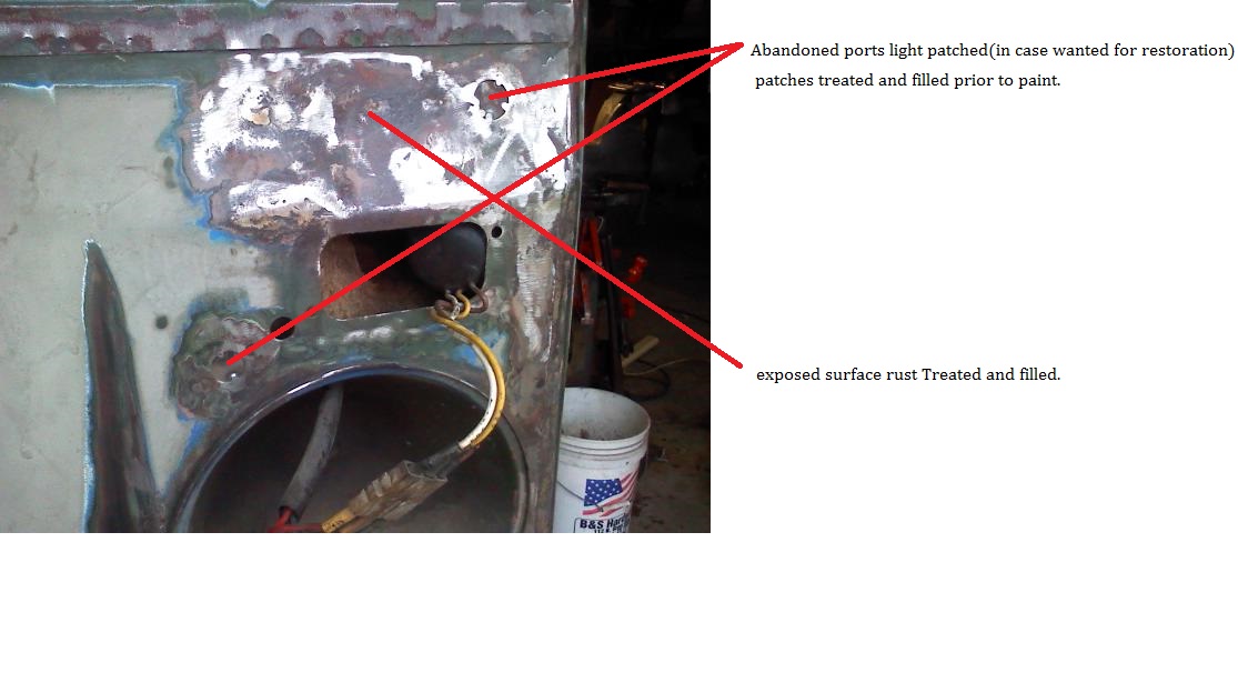

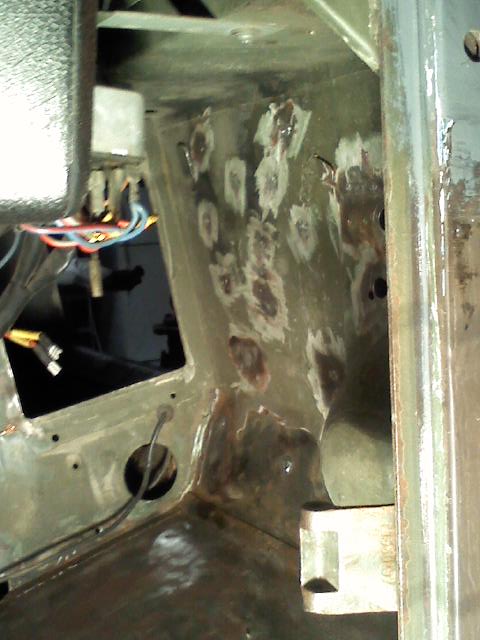

More body progress pics.
As a whole, the truck wasn't near as bad as Gecko tours' rig. I hope to get it done before his.

Re: Fat Fabrications c303 body restoration.
Post by geckoadventure »
Looking at the cabin rust I thought I was looking at my truck but then realized the rust was not as bad.
Good job.

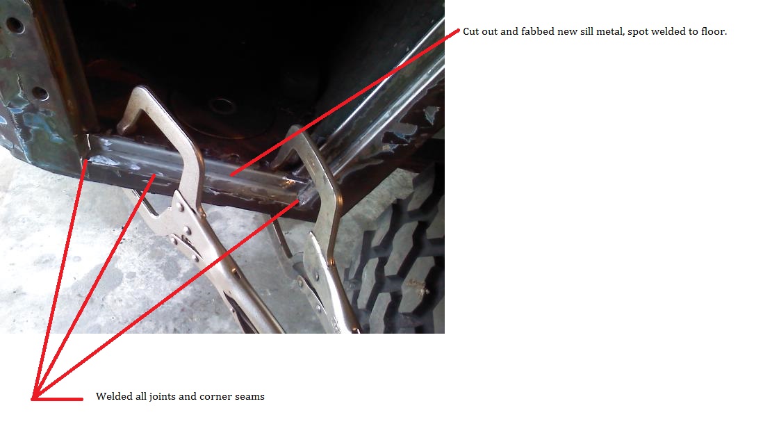

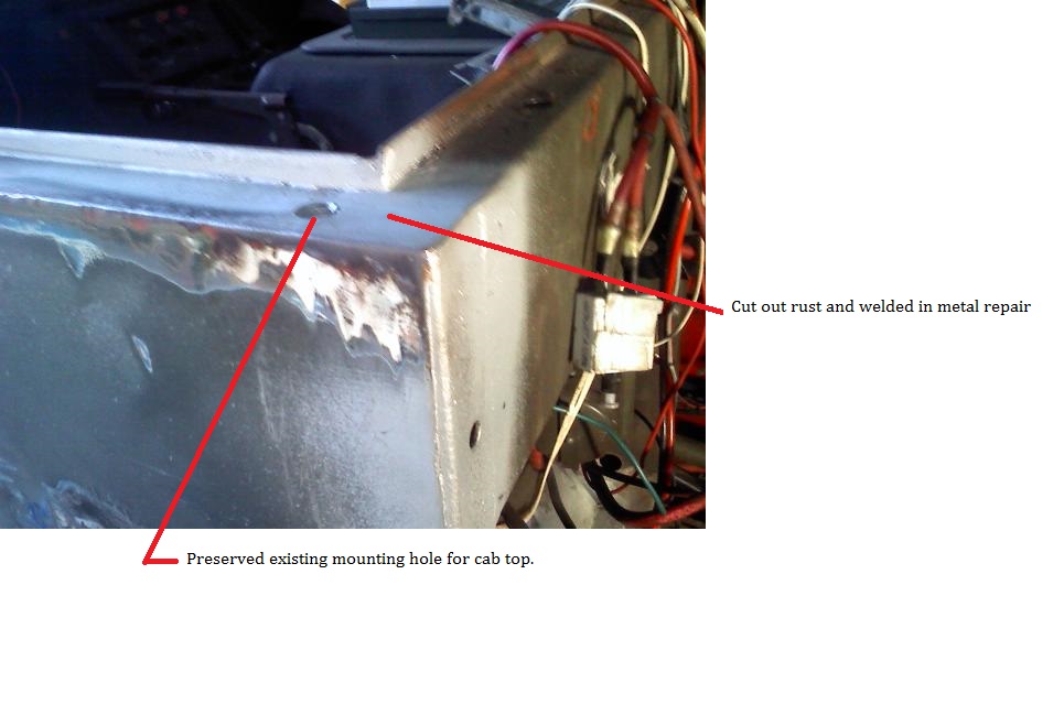

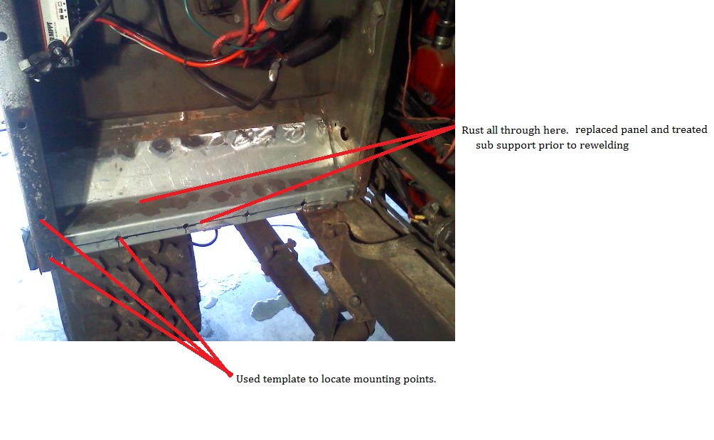

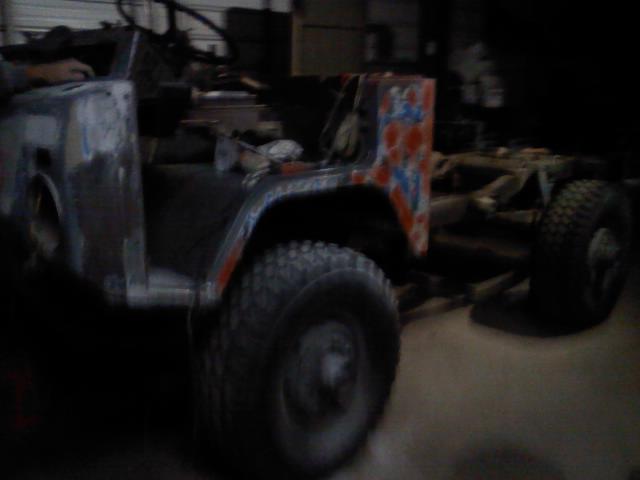

Drivers side rear floor
rusty warped body panels
removed...
replaced
Andre
Posts: 973
Location: Winnsboro Tx
Post by Andre »
floor repaired on the inside after new skins
rear fuel filler modified into the floor prior to new metal corner.
Right side skin installed.
both sides and rear panels replaced along with the rear door sill.
Grey is POR-15.
