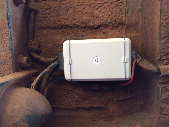

I was able to find an updated rear connection box with a cover on SAV and ordered it. I was thinking that the problem might have to do with the turn signal switch but Iʻm not sure yet. At any rate, I am going to have to hold off until the semester officially ends next week before I can check on anything else - Iʻm getting bogged down with final exams, grades, and frantic students.
I appreciate all the ideas so far. I will keep you posted.
- IMG_1759.jpg (285.72 KiB) Viewed 8662 times

That doesn't look like the wire connector I have under mine, it is in a sealed case!

I think that's the correct connector, but missing it's cover. It's been a while...
Re: No Flashers & Brake Lights...
That connector is like the ones I had on my Mog. I have a sealed cover on the rear of the pinz. It has a small screw that holds it onto the box with the wires and the wires go through something like a grommet to help seal out debris.
After I checked my breakers that was the next thing on the list to determine the cause of the non-operation of the brake lights. Paul gave me a clue to the possible cause being with the ground. Corrosion between the connector and the body prevented the electrical continuation of the circuit. Wire brush at the body and new connector on the wire solved the problem. I applied a coating of spray undercoating to cover the bolt to help prevent future corrosion to the underside of the pinz at that location.

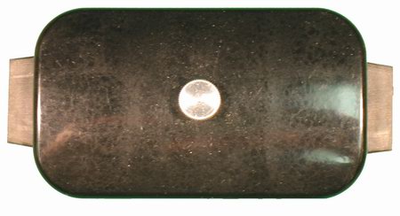

- Here it is for sale on SAV under the label "old style":
- shpicfile.jpeg (31.55 KiB) Viewed 8492 times

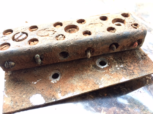

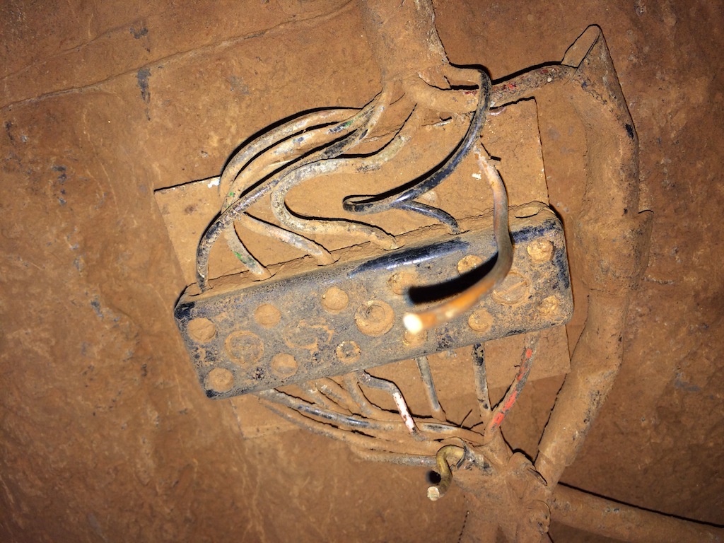

- Hereʻs my dirty corroded box:
- IMG_2009.JPG (129.79 KiB) Viewed 8492 times

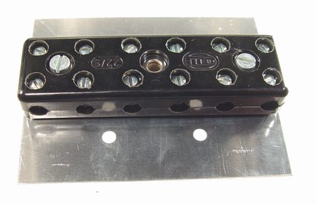

- Here is the upgraded box with a cover that screws onto the box on SAV:
- shpicfile (1).jpeg (19.84 KiB) Viewed 8492 times

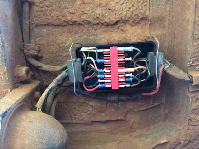

- The funny thing is that when the box actually arrived it seems I got an upgrade on the upgrade. Hereʻs what the new setup looks like:
- IMG_2015.JPG (118.59 KiB) Viewed 8492 times
- IMG_2017.JPG (106.96 KiB) Viewed 8492 times

I was hopeful that the rear connection box would solve the problem but unfortunately it didnʻt. I did crawl around looking for frayed wires, corroded ground connections, etc. but couldnʻt visually identify any problems. I played around with the #11 circuit breaker but it seems to be working fine. The nice thing is that I have access to another pinz so I can just swap out individual components to determine if they work or not, thereby allowing me to narrow down the possibilities more easily. With that said, the components I eliminated as the source of the problem, because they worked in the other pinz, are:
