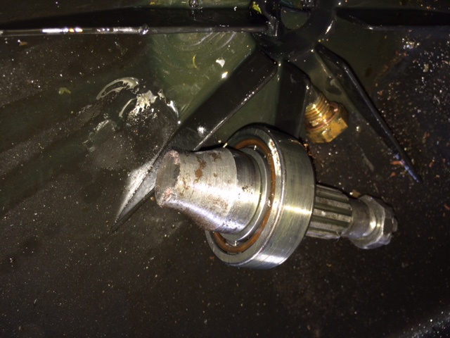

I have confirmed a broken axle.
- IMG_3194.JPG (108.21 KiB) Viewed 9557 times
Re: Rear drive failure...?
Are both rear axles the same? Or are they handed? Wouldn't have thought so, but with these beasts anything is possible!
Shame you have a couple of broken bits, but they don't look like it would really repair very well. So probably not worth even contemplating that - Replacement with preferably a new one, but if one can't be found then a good second hand one will have to do!
John
John
First one I've seen failed on that end
. I always find em on the inboard end.

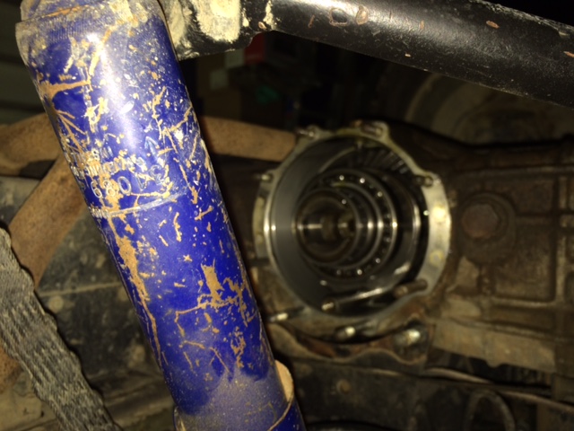

Thanks for everyone's help. Removed the axle arm today and ready to install the new axle.
- IMG_3270.JPG (115.54 KiB) Viewed 9365 times
- Posts: 940
- Location: Indio, California
I have tried to install an axle like you are going to do. I got so frustrated that I had to get Jim LaGuardia to help me out. Not sure how it was done at the factory, but they had to have a special tool or technique. Let us know how you did it.
