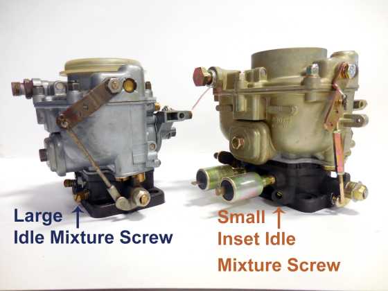

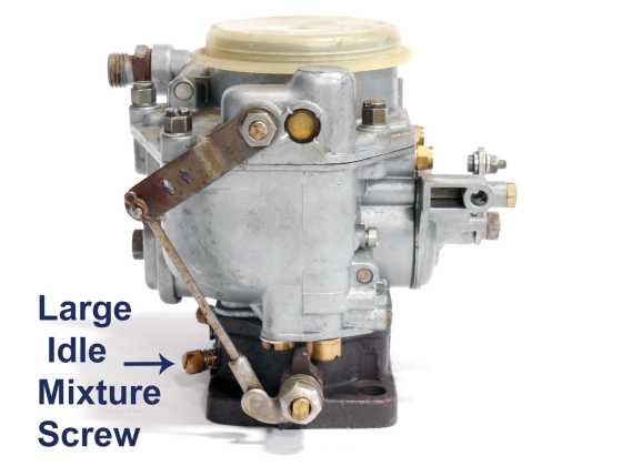

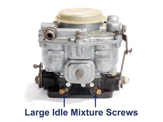

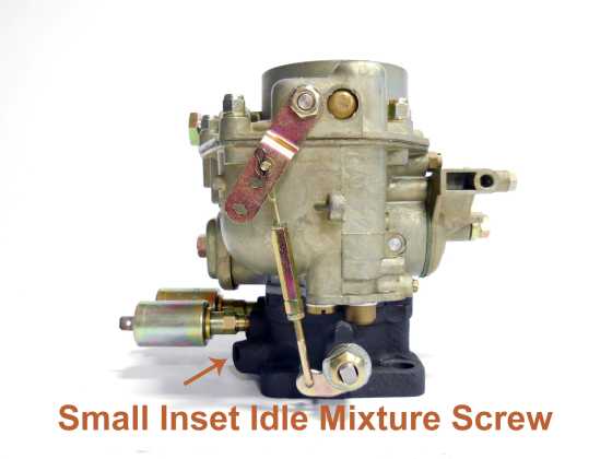

One of the Most Common Questions we get when people are ordering carb kits. Here are some pictures to help you determine.

thanks, helpful visual!

where are the solenoids on the large idle screws carb ???? same spot????

Same spots...

I’d guess the large screw carb is not setup as a Pinz carb, as the accelerator pump linkage and fuel inlet are also different. My guess is that Scott was only interested in answering the common question of small vs large screw. I’d also guess is that the one with the fuel solenoids is for a Pinz and the other is for a Unimog. Am I close?
