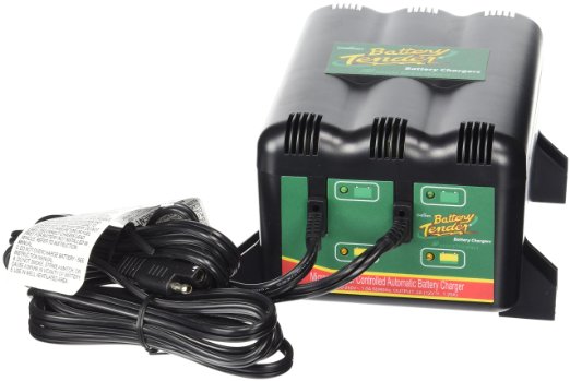

Like aclark79 I use a Deltran Battery Tender but I found this one: http://amazon.com/Battery-Tender-022-01 ... ery+tender
It charges each battery independently which works out well since one battery always seems to need more charging than the other. It comes with 2 short wiring leads that you leave connected to the batteries. The Battery Tender than plugs into those leads when you're ready to charge. Since its a battery maintainer it can be left connected for long periods of time if you want.

One of my winter additions to the truck this year. I got tired of having to charge one battery at a time.
I went with the "NOCO Genius GENM2 8 Amp 2-Bank On-Board Battery Charger"
Made up a small mounting plate (attached to the bolts that go through to the tool box) and everything fits in the battery box with 2 yellow tops batteries.
All I have to do to charge the batteries, is open the box and plug in. We'll see how long it last being mounted in the truck, but fingers crossed.
