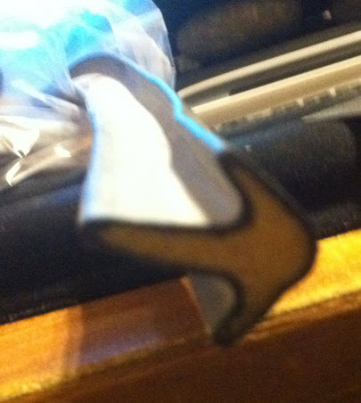

Two leaky doors and two rattlers, time to replace all door seals on the Mozo 1.
Waited two months for SAV to get the latest shipment. This stuff is different from prior runs.
It is still the same Trident shape (see PIX below), but fully extruded closed cell foam. Thought
I would share my experience with this new seal on the forum -- some +'s and -'s to watch out for.
The prior material noted by djw, is stiffer than the newer stuff with a less compliant yellow'ish foam core.

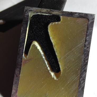

I can't cut strait to save my life. With this new material you now get to cut your own corners for
the 45's. For this I made a Miter and a Joiner. The Miter is made from 1 1/2" square aluminum
tube. Find a seal long enough to cut a 5" to 6" piece to make a mold from. Use non hardening
gasket seal Permatex #2, apply a thin coat of Vaseline on the lobes, insert in a corner of the tubing
and pour in 2 part molding compound. After the recommended curing time, pull the sample out and
presto a copy of the seal cast in the tube. I cut the 45 on a table saw using a high point count Tungsten
carbide blade -- cuts clean but move the material very slow. Polish the faces with Emory as this will be
the cutting surface with a razor. I used the longest razors I could find. You have to think through the angle
to cut the 45's -- you get one chance to get this right :)
6" piece I pulled form the mold I used for trial cuts and corners -- good practice.

Miter. Made from 1 1/2" Square aluminum tube. Tack in 6" sample of the seal material in one corner, use no-hardening gasket sealer and Vaseline on the lobes. Pour in molding compound, let cure and pull the seal out. Cut 45 on a table saw.

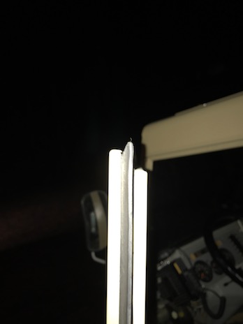

Fitted and ready to cut, use long razor blades, each is good for about 5 to 6 cuts before dull.
Cut and ready to join

I'm using the same material as you. A question. The seal is arrow shaped. It fits in the U channel around the door perimeter.
Where does the arrow "point" go? U corner on the glass side, or the outside?
Described differently, on your last photo, top run, does the arrow "tail" point 45 degrees up or down?
Posts: 1559
Re: Door weatherstripping replacment
Dono if this PIX helps. Basically you want the rubber leaning toward the chassis so
that when the door closes the rubber is pushed outward creating a seal. So get the
lower corner into the outer part of the door frame with the tip leaning toward the
truck open frame. Hopefully the PIX makes more sense :?
Incidentally, it's been 2 years and the corners are still holding strong from the mitered
corners and the adhesive I used.
good luck.

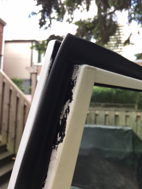

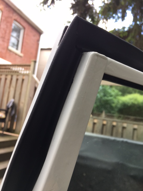

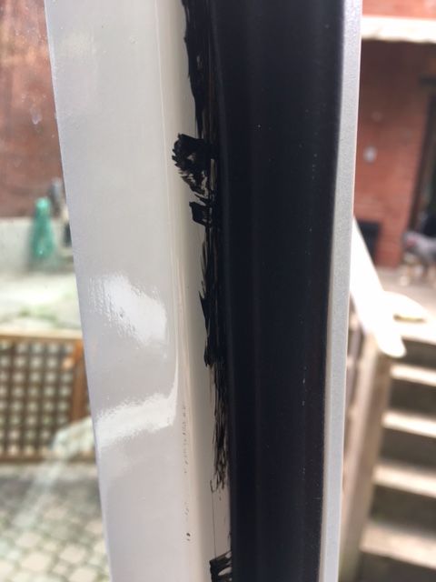

Old thread but I had it bookmarked.
Just cleaning up a few small bits and my passenger door seal was coming off a bit.
I cleaned up the channel (removed 3M yellow - used PRE to soften and then a dry towel, came off quickly)
Used the 3M black as I did not like the look of the yellow - used a small brush to spread it
Andre did my corner cuts so they were good
Did not worry about getting the black all over, more concerned with correct placement as it was super easy to clean excess with the PRE solvent
More mess cleaned up - thanks as this thread heaped me before I started!
Last picture
