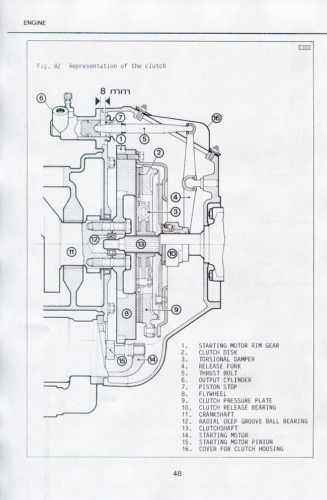

How do I know if the clutch-slave is engaged ? The repair manual is tight on details, but it looks as if I need to remove the cover for clutch housing (no 16) to see if it engages ? ie that (No 5) thrust bolt and therefore N0 4 release-fork moves ?

PS anybody else reading this: just in case I need to remove the clutch housing later, would it be usefull to replace parts, that usually are worn ? clutch-plate ? What are the cheapest and easiest parts to replace ?

I had to weld a small bead onto my thrust shaft as it was slightly too short. Now that its worn, I need to take a mm off

I doubt that you need to modify the length of the clutch push rod. Things worked fine when you parked it, it hasn't changed length. You didn't mention that the clutch "feels" weird either. I suspect that you are pushing the throwout bearing down, but the clutch disc is stuck to the flywheel and/or the pressure plate so it won't release.
