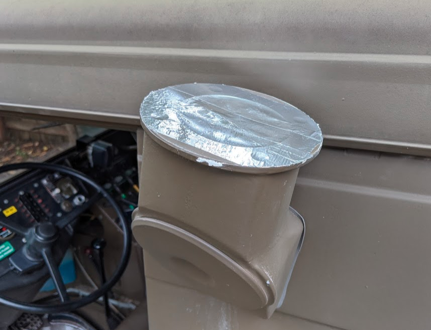

Post by ChickenPinz »
Anyone found a good solution to cap off the 710K antenna mounts? I've covered mine with tape until I can find/make a plate. It's 140mm diameter, with four 10mm holes 115mm center-to-center across (72.5mm from disc center). Ideally, it'd be a black ABS disc or metal.

The caps are getting hard to find. Why not plug that up with what was intended to go there.
The mount is actually SAE 4.5" BHC, long story short the Swiss/European radio were not
ready for deployment in the early 70's. They went with U.S. Radios. The Packaging of what
goes where and how many was their choice -- but it's mostly U.S. including the Antennas
and Mounts. The MX-6707/VRC was what these rigs used. I've seen them on eBay, you can
tweak this particular base and associated whip to 11M e.g. CB. Not good for HAM VHF/UHF.
Point is, look out for any U.S. Mil Antenna Base with 6.5" BHC and it will fit perfect.
There's a thread on the forum for more choices if interested.

For now, I'll just fabricate some caps for the mounts (secured with 4plc M10-1.5, 10mm tapped holes) until I can decide if there's more than aesthetic value to the antennas themselves since they are the tallest feature on the truck (read:height constraint). My interest would be ham (W3LX), and mostly 2m operation. Not sure if they'd do any better than a center spike NMO mount in the roof plate, though. That's what I run on the FJ and it does pretty well with the roof ground plane.
Oh, and I have the full antenna setup -- it's just that I pulled them to lower the height and want to cap the holes.

Though a bit pricey, it appears SAV has the covers in stock. 31-35-03
75 Swiss 710K

Indeed. $39.50 each is a bit much for a round disc with four holes. https://swissarmyvehicles.com/pinzgauer ... base-swiss
I'll likely just fabricate some either out of ABS or aluminum. If others need them, please PM me and I can see about getting extras made.

If you plan to fabricate out of plastic it is best to use Marine-Grade Moisture-Resistant Polyethylene (HDPE). "Also known as starboard, these sheets won’t degrade when exposed to salt water, humidity, and UV light. They’re more rigid than standard HDPE sheets, and have a coarse texture that masks scuffs and scratches."
Available from a variety of online sources. A 1/4" thick 12x12 sheet is about $10.00.
Use an appropriate sized hole saw or a sabre saw to cut a circle and then just drill the four holes.

For my old 710K I designed a simple file to print the cover for the antenna side mounts.
I uploaded it on thingiverse. You can also print it in black, green or any color available. I would recommend PETG as material since it's immune to UV light and moisture.
