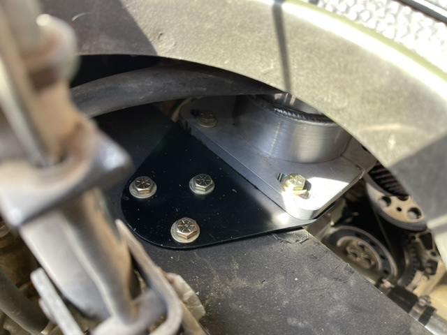

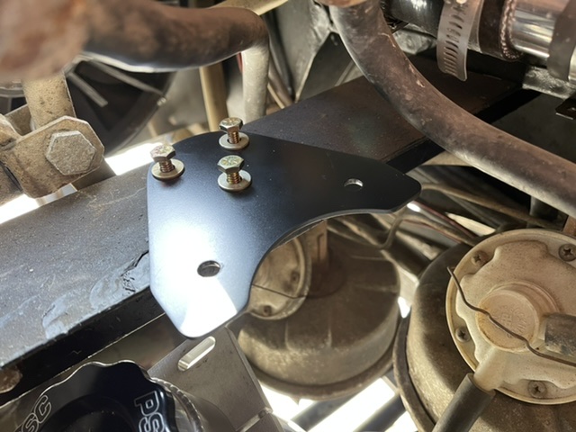

Finally getting around to the final bracket to hold the PSC power steering reservoir. This places the reservoir on the brace that holds the throttle link rod setup. The reservoir is accessible through the center engine cover and is to the passenger side. I’m not sure if this will work for a stock gas truck.
