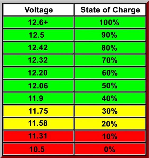

Consider the state of charge for a 12V AGM battery and that you might not
want to go below 50%. Attached table (typical), suggests about 12.0V/battery,
or 24.0V as your safe set point.
You may also want to check the open circuit voltage of your batteries after a
long drive and where the alternator took you to. It would not be too surprising
it's a bit below 100% charged (25.2V+) as these regulators were designed for
Wet cell batteries.

Good info, Ron. I had started with a similar chart and assessed 24V as my safe point, but thought there might be some folks here with more smarts and experience than myself who might weigh-in on the topic. Thanks for the feedback.
