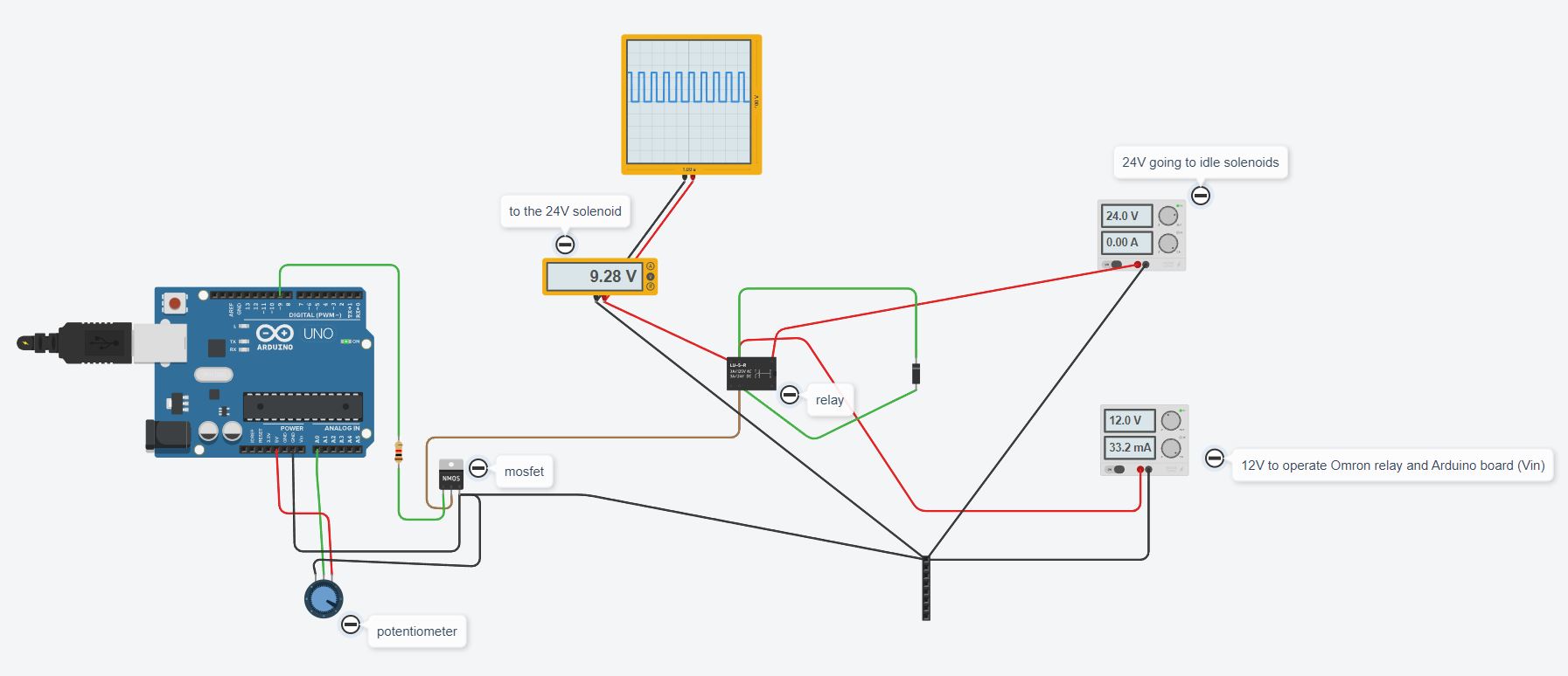

I have designed a simple electronic board using an Arduino Uno, a potentiometer, a mosfet and a relay, that can cycle on and off the 24V line going to the idle solenoid valves. And it works :D
In the video, after letting the engine warm up, we can see on my tablet that the AFR is too rich (~13) and the idle is around 740rpm. At this moment the idle solenoids are always opened, so fuel is going through.
As I slowly turn the potentiometer, i start to change the duty cycle of the solenoids from 100% on towards 20% on progressively. As i do this, you can see the AFR going up to around 14.5 as fuel supply is reduced, and the idle comes down to around 660 rpm. I'm currently cycling them at 10Hz, so they switch on and off 10 times per second, and the potentiometer adjust the time they are opened (duty cycle).
I know i can adjust my idle mixture screws to avoid having a too rich mixture, but i have done that many times and somehow the AFR is not always right, depends on air and fuel temperature and other things too.
So the next step will be to use my ECU to drive the idle solenoids based on AFR instead of me through the Arduino board and potentiometer. What i don't know currently is if these solenoids can tolerate being switched on and off like this, i could not find the solenoids specification. For now I will try to keep them at 100% duty cycle and only cycle them when my other method below is no longer able to correct the AFR.

Below is the diagram of my test board, in Thinkercad, for those interested to follow me down this rabbit hole :D
