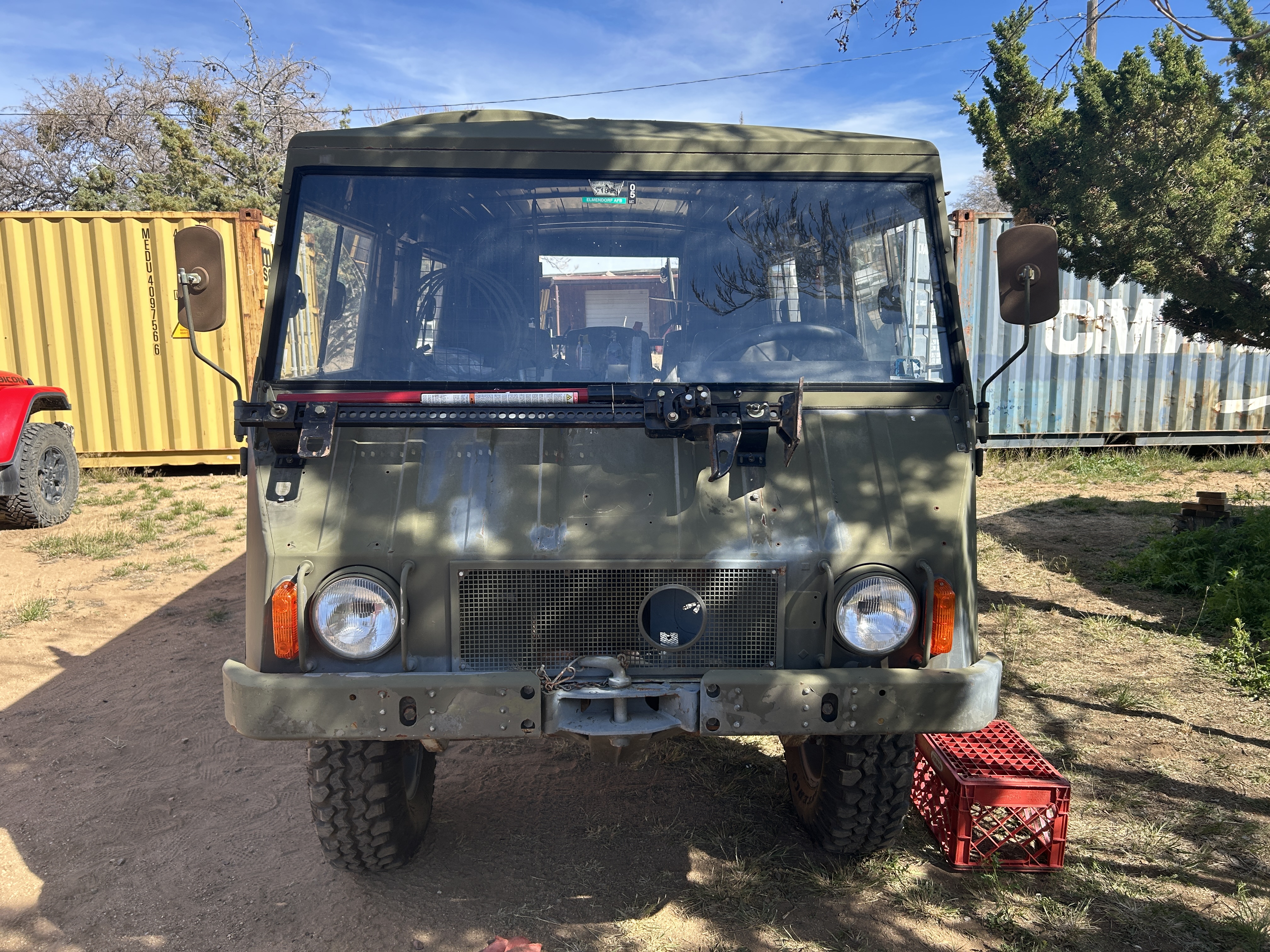

Re: The project 710K Begins.
Still lots to do while waiting for brake parts to arrive.
Today, I installed and wired the headlights and got started trying to sort out the taillights.
- IMG_7574[1].JPG (4.15 MiB) Viewed 128 times

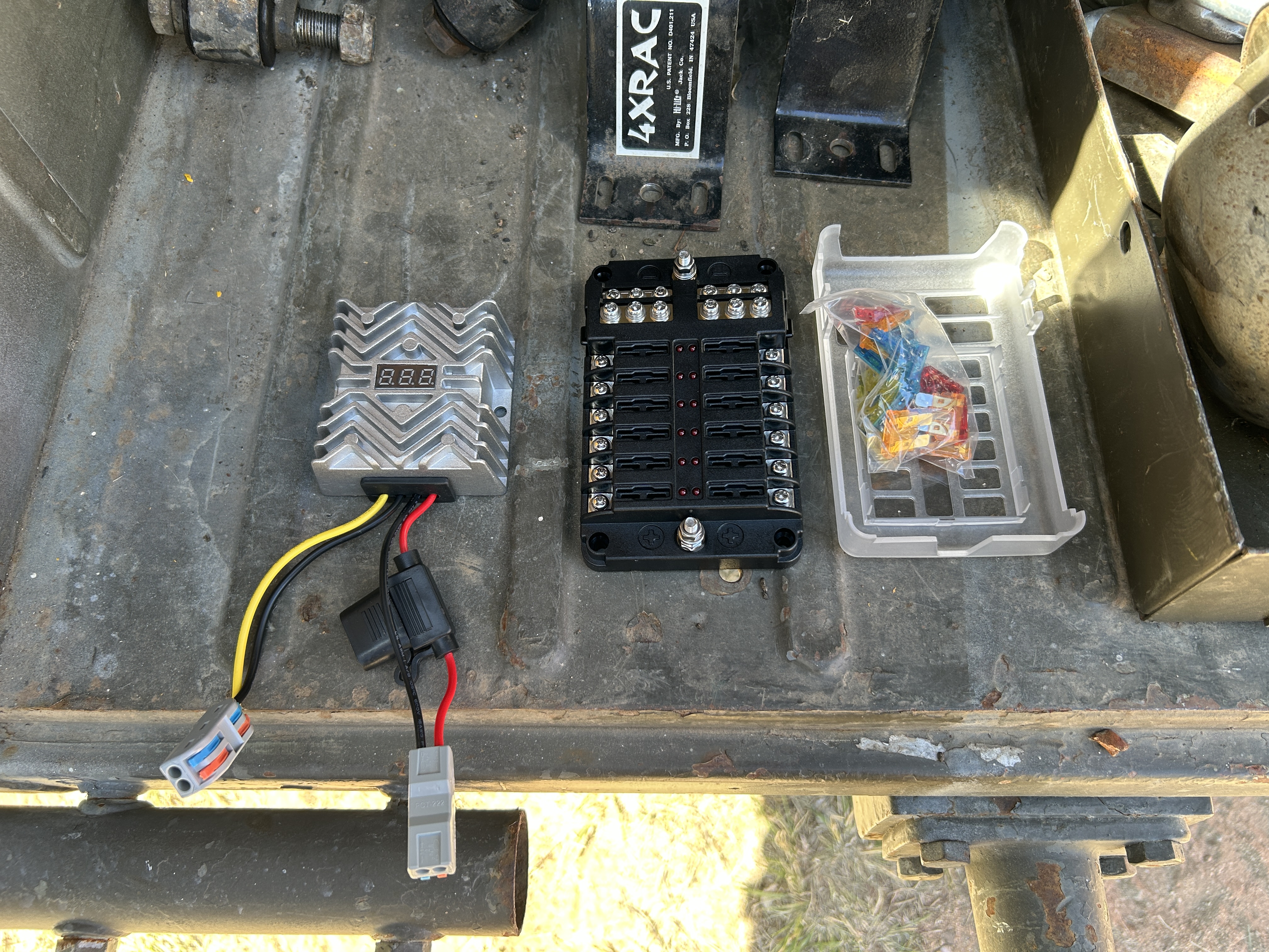

Still sorting out the tail light wiring. The color schematic I have is for a 710M, not a K. Most of the colors are different. But I have my trusty volt meter.
And I don't seem to have a junction box as depicted in several photos online.
There is a constant "on" black wire in the right rear wire harness. It must be for a power plug.
And look what came in the mail today. A quicky volt meter and my co-pilot.
- IMG_7576[1].JPG (2.39 MiB) Viewed 107 times
- IMG_7575[1].JPG (2.79 MiB) Viewed 107 times

ChickenPinz
- Posts: 440
Yes, this is exactly where your Garmin Overlander goes.Mr Zero wrote: Mon Mar 02, 2026 1:50 pm I hate to be the bearer of bad news, but you’ve planted Vault Boy exactly where your future GPS speedo antenna puck is going to live. Really hoping he’s on a mag mount… otherwise he’ll have to get evicted.![]()
On the left side, here's my solution for DC power jacks -- I added a double-wide standards-size (still 24VDC) receptacle in front of the euro style socket.
On top is the voltmeterhttps://a.co/d/0hcQomdq.
This is probably the best 24V tolerant charger I've found: https://a.co/d/04SOAyS0
- PXL_20260303_020334923 (Large).jpg (261.26 KiB) Viewed 66 times
- PXL_20260303_020311523 (Large).jpg (414.52 KiB) Viewed 66 times
- PXL_20260303_020301429 (Large).jpg (378.09 KiB) Viewed 66 times
