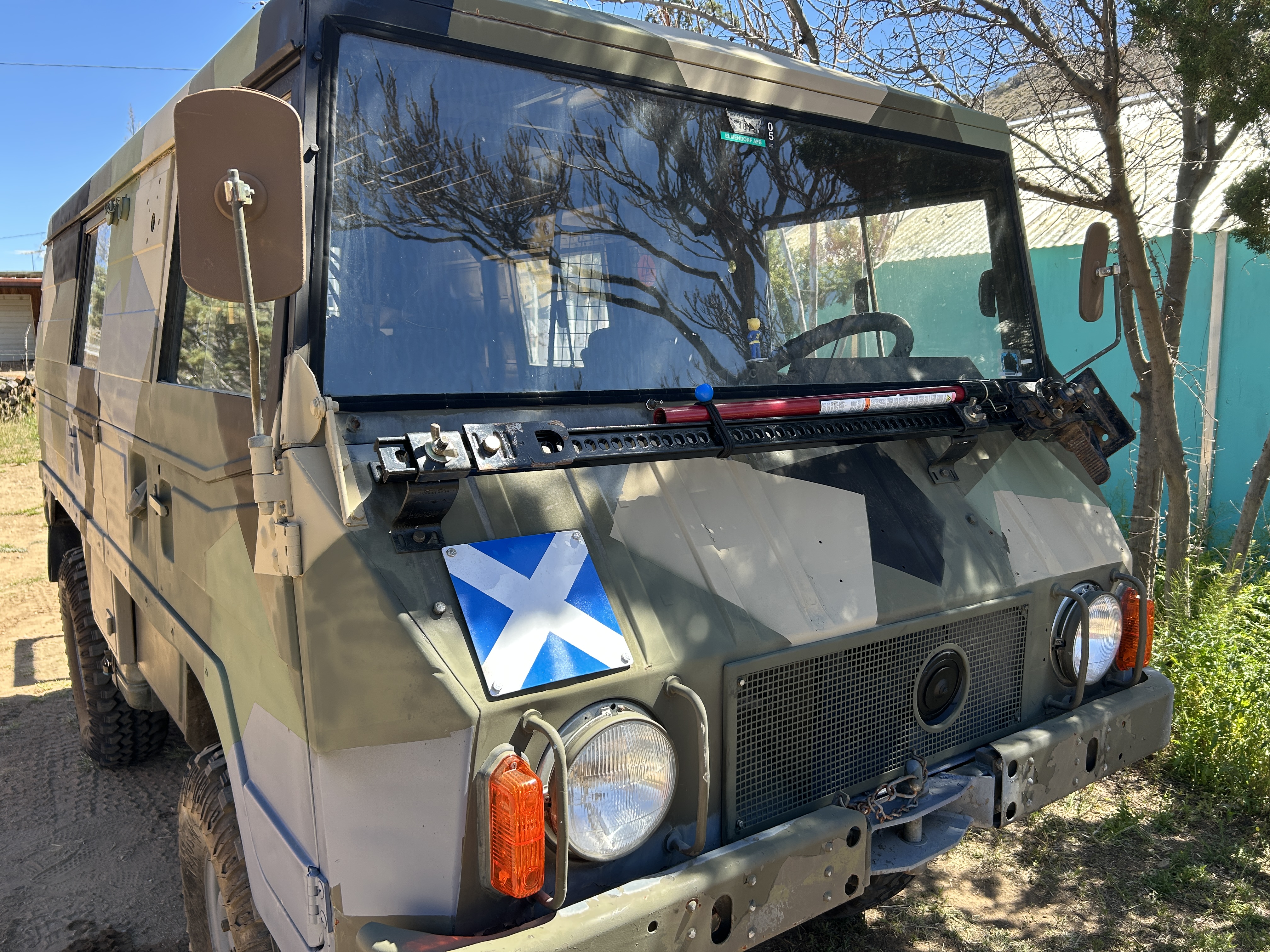

Thats enough painting for now. My brake parts are here. 🙂
Regards,
Jim

Where would that jack even work on a 710? Nowhere from the sides that I can think of, the rear bumper maybe. I would think the front bumper sits up too high. Serious question as I think it looks cool but wondering how practical it is.
EDIT.. Are the wheel wells strong enough to lift there?
Tim
1975 710K
Mr Zero
Posts: 204
Joined: Fri Dec 11, 2009 1:28 pm
Location: Nevada
Re: The project 710K Begins.
Post by Mr Zero »
compunerdy wrote: Fri Mar 06, 2026 11:07 am Where would that jack even work on a 710? Nowhere from the sides that I can think of, the rear bumper maybe. I would think the front bumper sits up too high. Serious question as I think it looks cool but wondering how practical it is.
The Hi-Lift can be used at the front and rear bumpers, but do go into it aware that slippage is the thing to watch for. On a Pinz, that’s less a theoretical concern than a practical one.
If you intend to rely on it, I’d recommend having a channel welded to the underside of the bumper near both ends to give the jack tongue a more positive purchase point. That makes the whole exercise a good bit less sketchy.
That said, I personally would not look at a Hi-Lift as a good maintenance-type lifting solution for the Pinzgauer, and I would not use it in the wheel wells. For routine service, the factory bottle jack or something similar is generally a better and safer way to get the truck in the air.
Where the Hi-Lift makes sense is as a recovery tool for odd circumstances — the sort of situation where you need a little lift, shove, or repositioning in the field and are working with what you have.
Alaskantinbender
Posts: 26
Joined: Tue Jun 21, 2016 6:33 pm
Location: Willcox Arizona
Post by Alaskantinbender »
I totally agree. I have never used it to change a tire. But many times over the years have used it as a recovery tool, repositioning the truck or (slowly) as a manual winch.
Mr Zero wrote: Fri Mar 06, 2026 11:37 am
Regards,
Jim

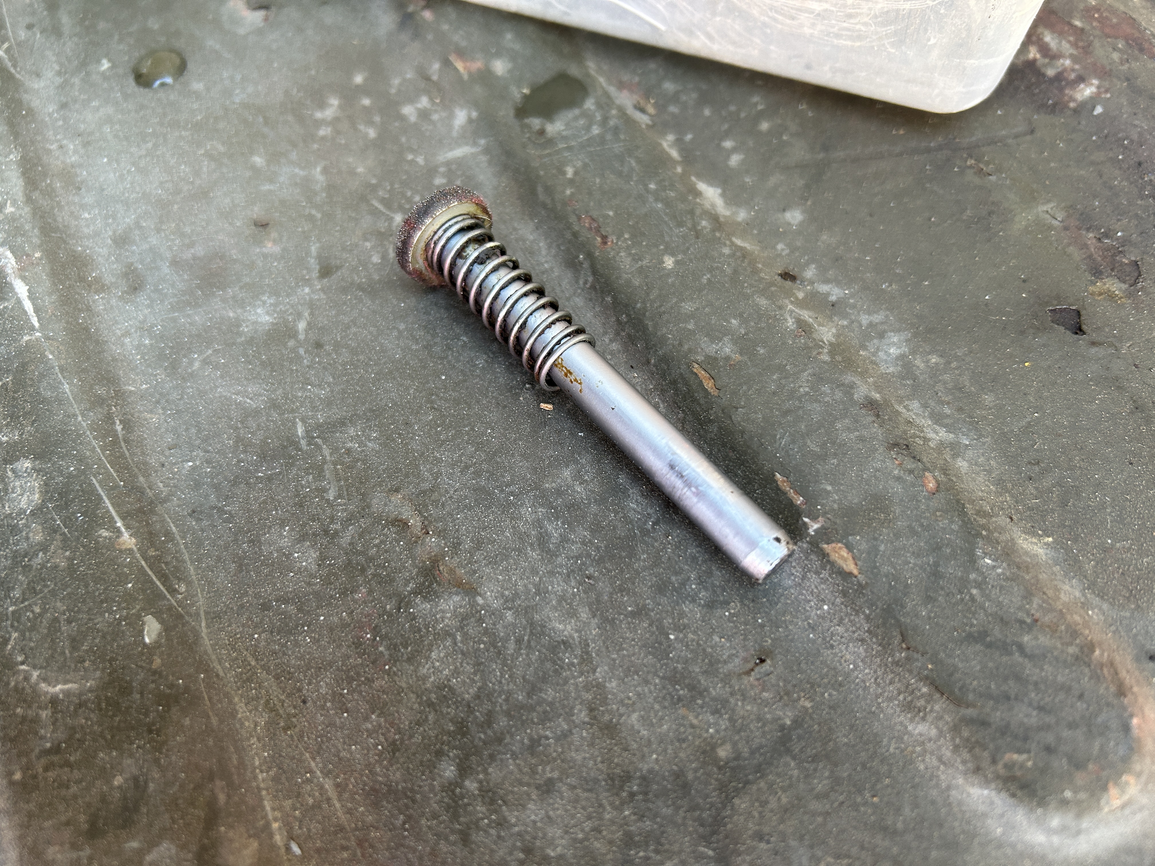

My 60-inch jack bar showed up. Still waiting for more brake and locker parts.
Does anyone know what this pin and spring are for? It's in my box of parts for the truck.
Regards,
