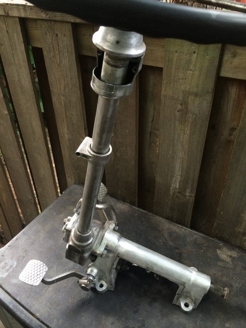

While you have your steering box out, you should check the condition of the tube that carries the horn wire up to the steering wheel button. It's welded onto the bottom plate on the gearbox. My horn wire "conduit" rusted out and is now leaking steering gearbox oil out onto the floor...
My theory is that this happened to me as a result of no button being present to cover that tube and the vehicle being left out in the elements.
Posted: Wed Sep 30, 2015 11:13 am
Striped and rebuilt it last year or was it the year before :mrgreen:
Like I said - process is soooo slow!
I agree - good thing to check and your most likely correct re: the open tube

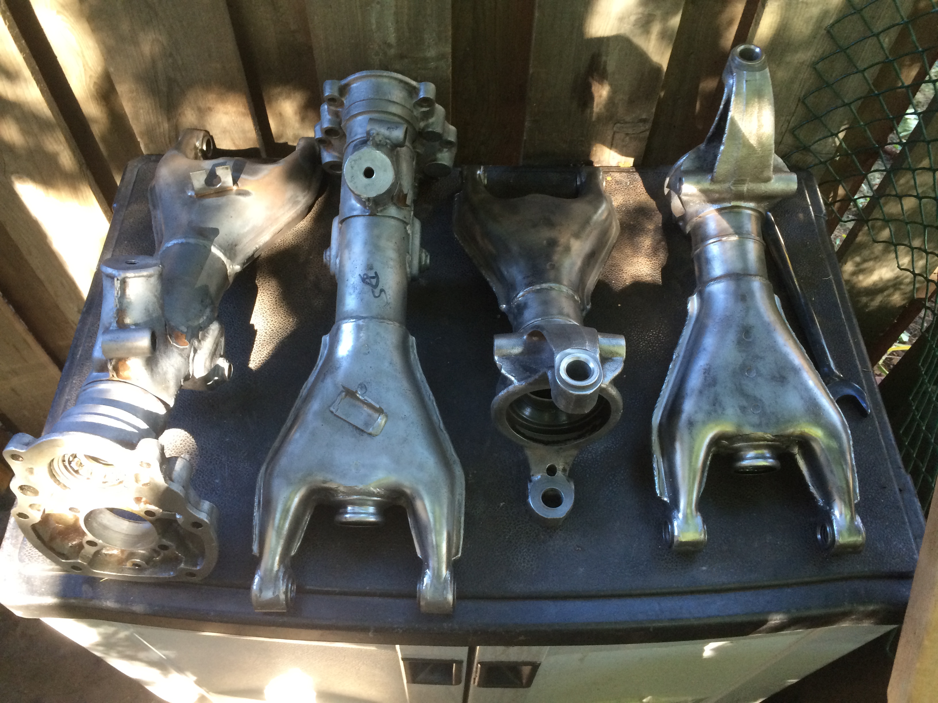

Finally some parts ready for paint
The shock/spring towers, springs and a few other parts are off at the powder coater

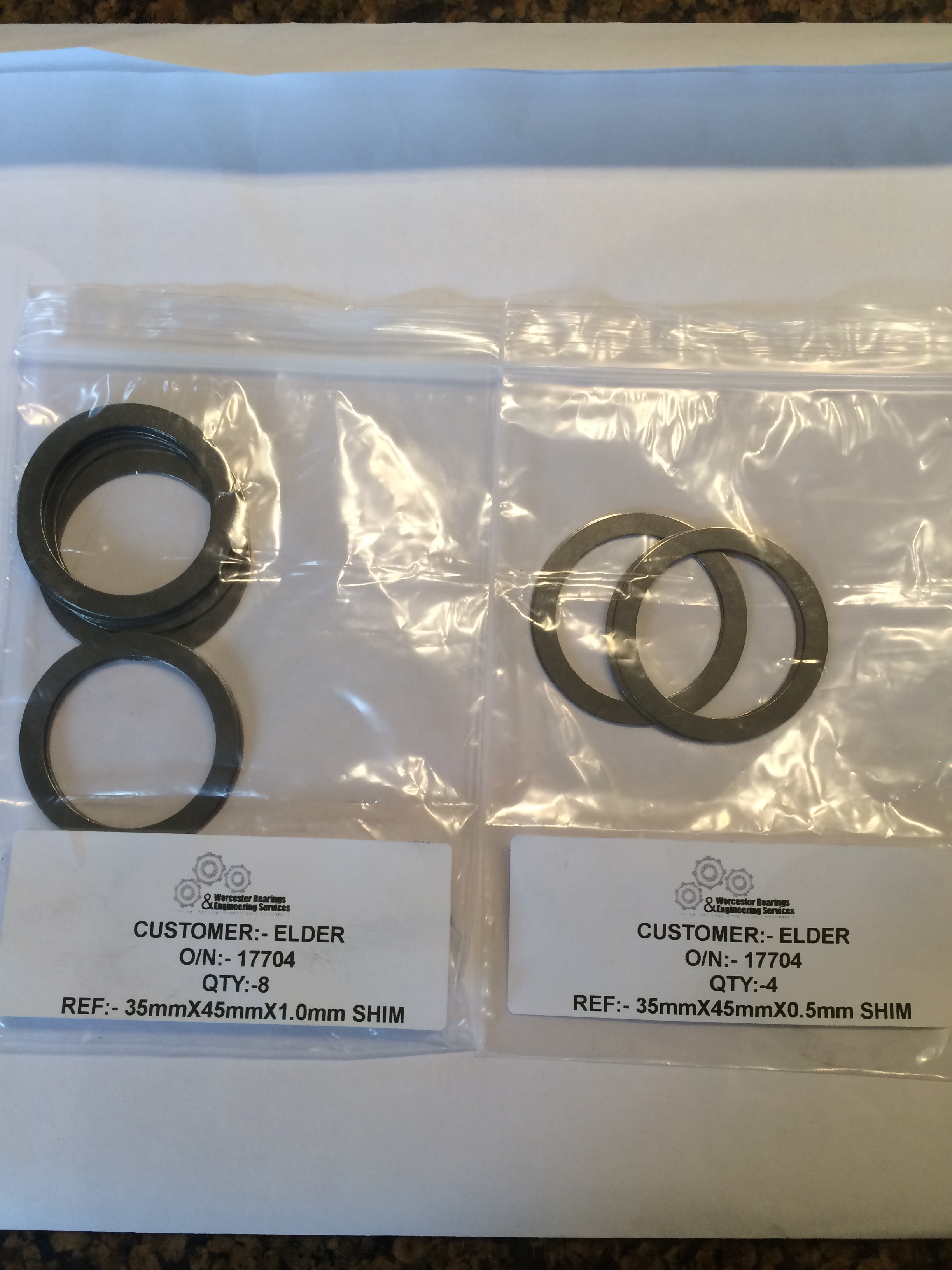

Found some 1mm and 0.5mm shims for when I do the hubs/gears.
