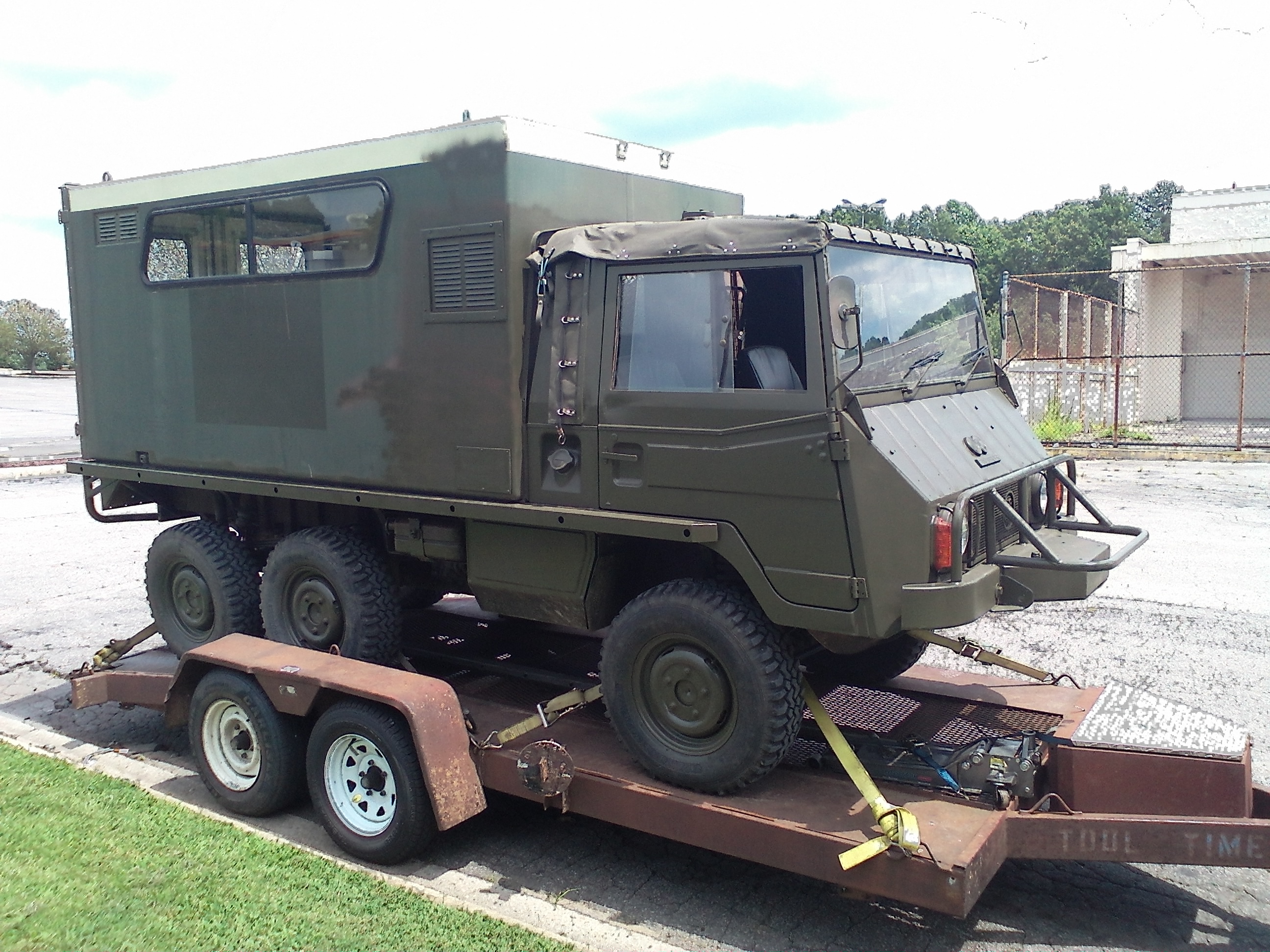

- IMG_20160722_142357.jpg (1.51 MiB) Viewed 157780 times
Just I ordered my kit for the new truck.
