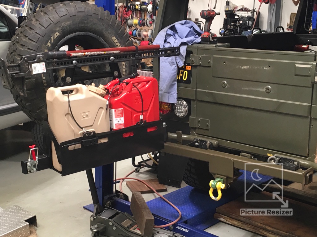

I guess I should have planned this earlier. I want to fabricate some kind of cooking surface to the swing away. Any idea are welcome.
Re: Laying out tire and jerry can swing carrier.
Maybe you should be glad you didn't think of that cooking surface -- mighty close to that 20L Jerry can -- no? Kaboom
Curious, you must now be close to 200lbs on that Spindle. Worried about the cantilever force when your backside hits (or falls)
an obstacle? Could be a fair amount of G-force there. Wondering how you anchored on the latch side and provided torque
strength -- can't see that clearly in the PIX's.
Looks mighty nice though!

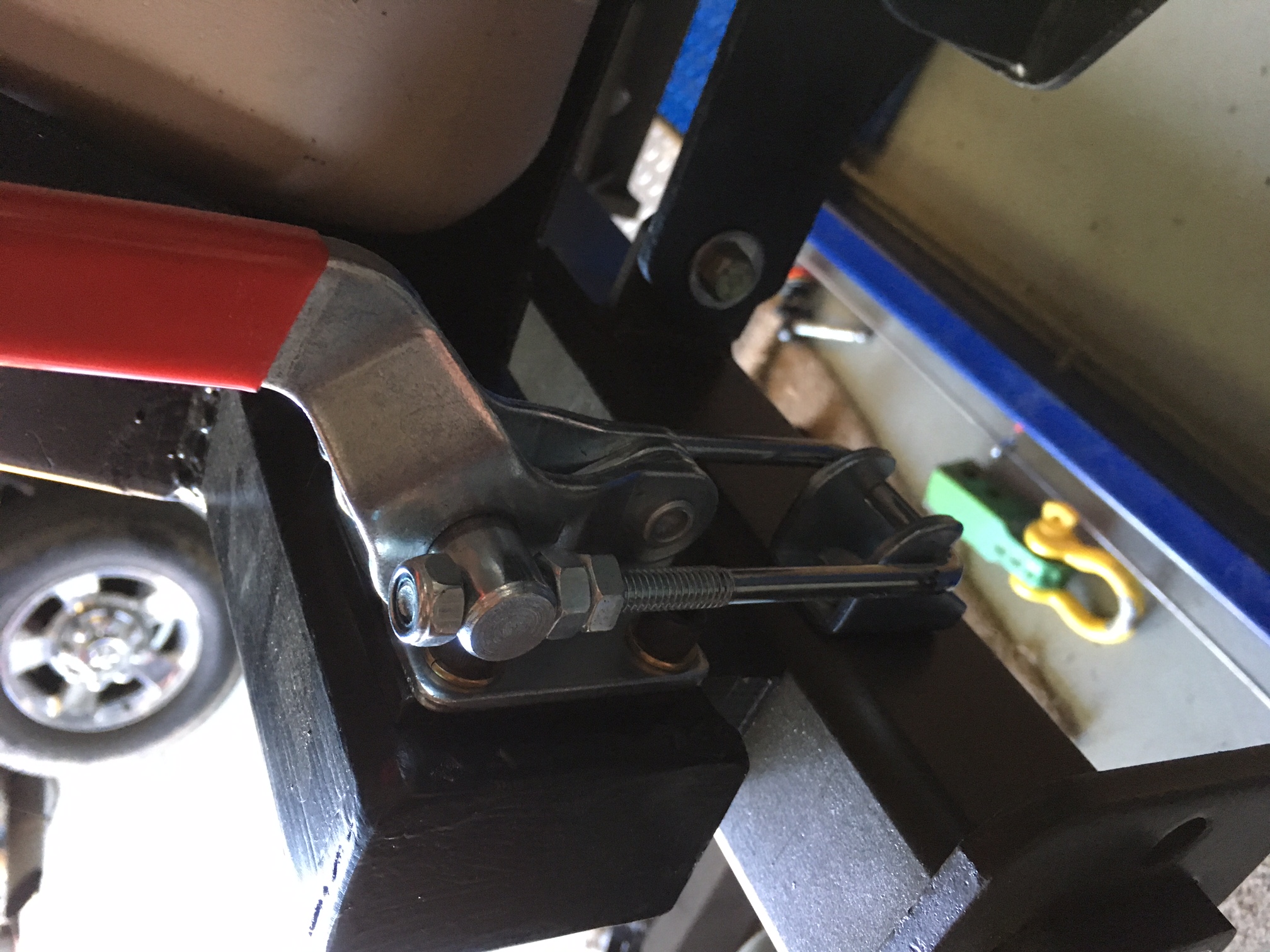

When swing away is closed there is no weight on the spindle. I elevate it about a 1/16 of inch on to the pad, then lock it in place. There is definitely 200 lbs on it when fully loaded without trash bag.
