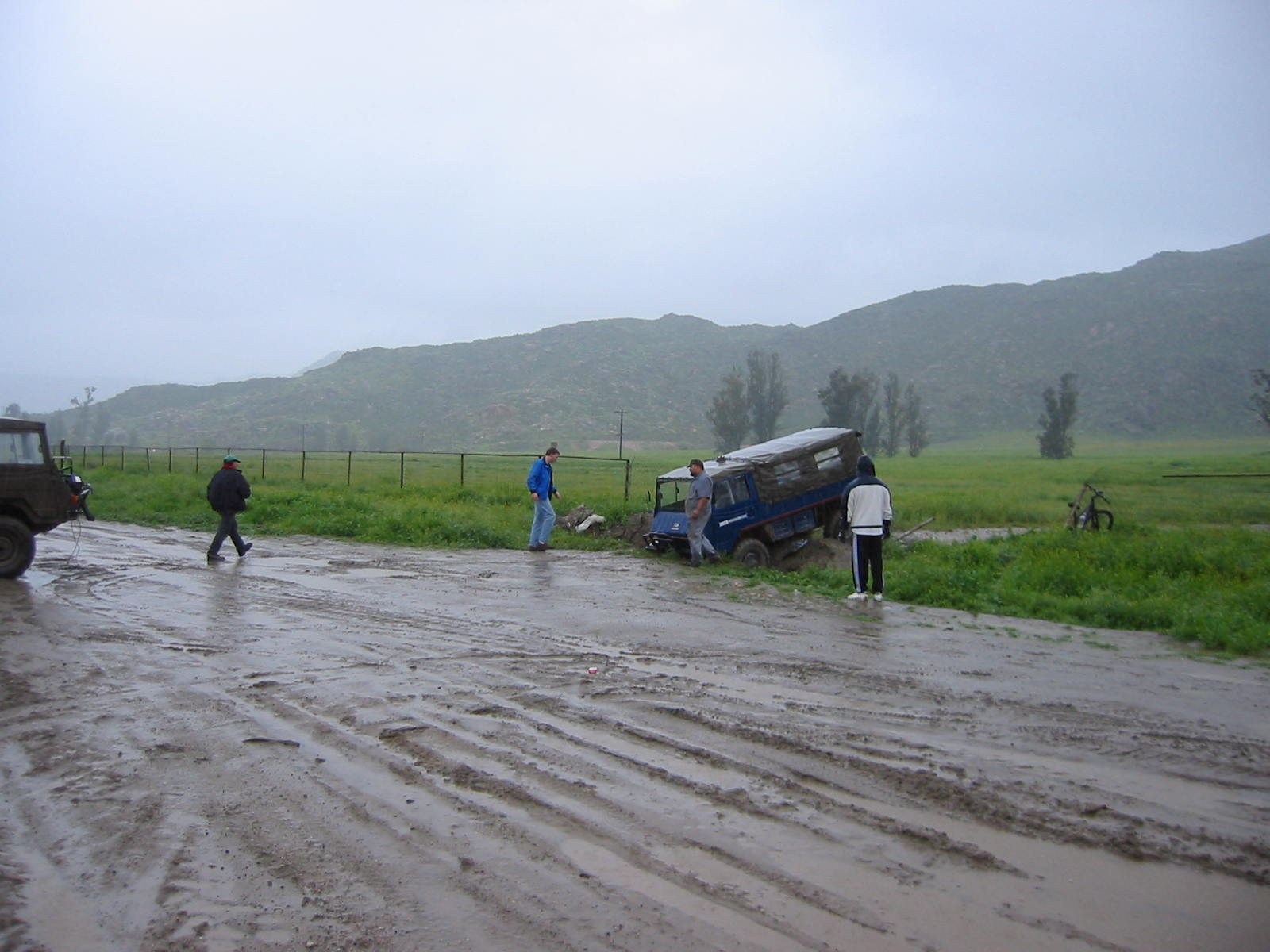

Mud bogging In Mount Santa Rosa.(see pic in upper left occasionally) spent 3 hrs washing out everything.

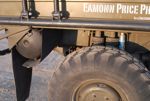

Doetsch tech shocks
Post by berger »
Hi Andre!
P.S.
See the shocks? :D
