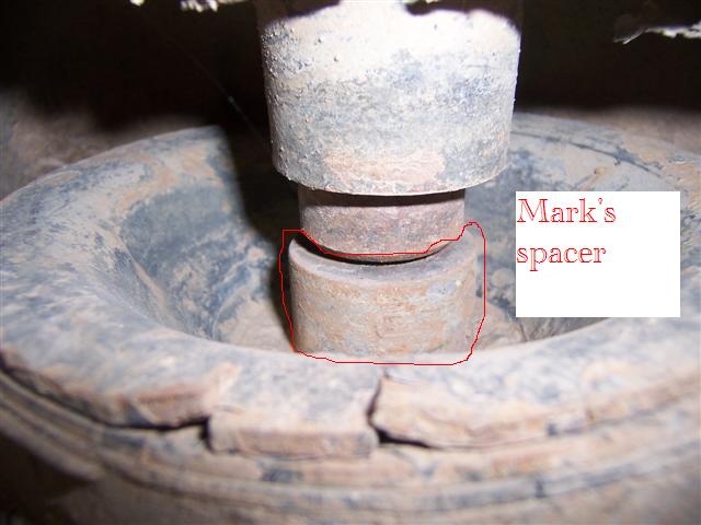

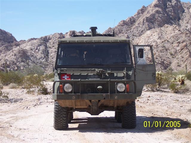

best photo I can get of the spacers Mark made for my Pinz. also a comparison photo set of the before and after effect.
- Mark's spacer installed
- spacer 002 (Small).jpg (43.09 KiB) Viewed 8873 times
- after installing spacer
- rug road 556 (Small).jpg (41.62 KiB) Viewed 8875 times
- before installing spacers
- 100_3307 (Small).JPG (66.33 KiB) Viewed 8875 times
Re: Coil spring spacers?
I realize that the after photo is not that great but it is the only one I have currently of the front of the truck sitting still. You can see that the tires are standing straight up, unlike in the before photo where there was a substantial lean to the tires.
I also experienced a "lift" in the front end of the truck. I have not noticed the lack of travel in the suspension as I thought I might.

I also am interested - my 710M rides great - just would like to lift the nose a bit and correct the slight angle-in of the tires at the top - especially if I finally add anything more to the front.
Seems like adding a spacer at the top (or a longer pin at the bottom - part #19) would result in the internal rubber bump stop making contact sooner though - which isn't necessary that big of an issue - it is more of a rubber "overload" spring in some ways. slightly less front end travel would result. I have heard of people cutting the front rubber bumpers down a bit to increase the front end flex on lightly loaded Pinzgauers though - maybe that would be an option...
The only way to not affect the travel range is to replace the spring with something stiffer or longer.
So - I guess either end could of the spring could be done - making a longer screw at the bottom might be easier (cut and weld in a section - grind to a taper?). I would think instead of making an additional spacer for the top it would be better to just replace that spacer (Part #1) entirely with a new one that is a bit longer - looks like a simple part to make up on a lathe?
Either way you need a spring compressor to do the job though... I've had to top cups out to replace - I don't remember taking that part (#1) off - but it was probably was wedged into the recess.
