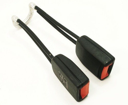

I could not see the photo above a t work. What is the definition of a "MKI" VW? What year span and which model(s)? Thanks, this has been very helpful.

mockingbird812 wrote:I could not see the photo above a t work. What is the definition of a "MKI" VW? What year span and which model(s)? Thanks, this has been very helpful.
Most of the VW models....Golf, Rabbit etc...from the 1980s. Even eighties Audi models will fall into the same category. I had Audi seats in my Iltis and they would also fit a Golf/Rabbit.

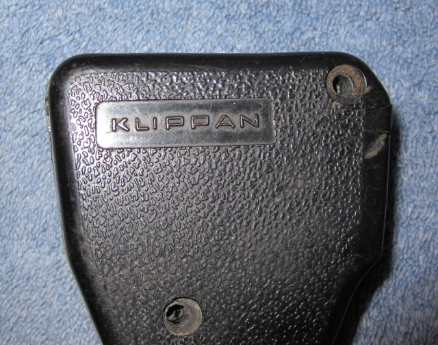

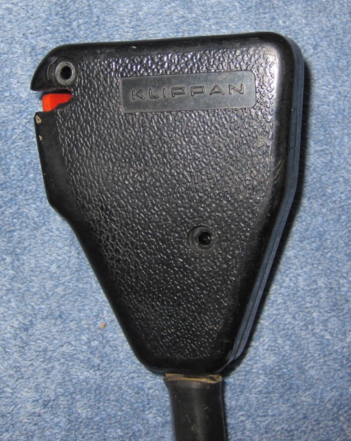

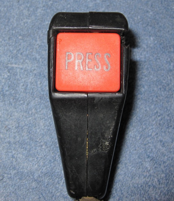

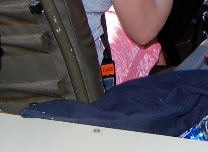

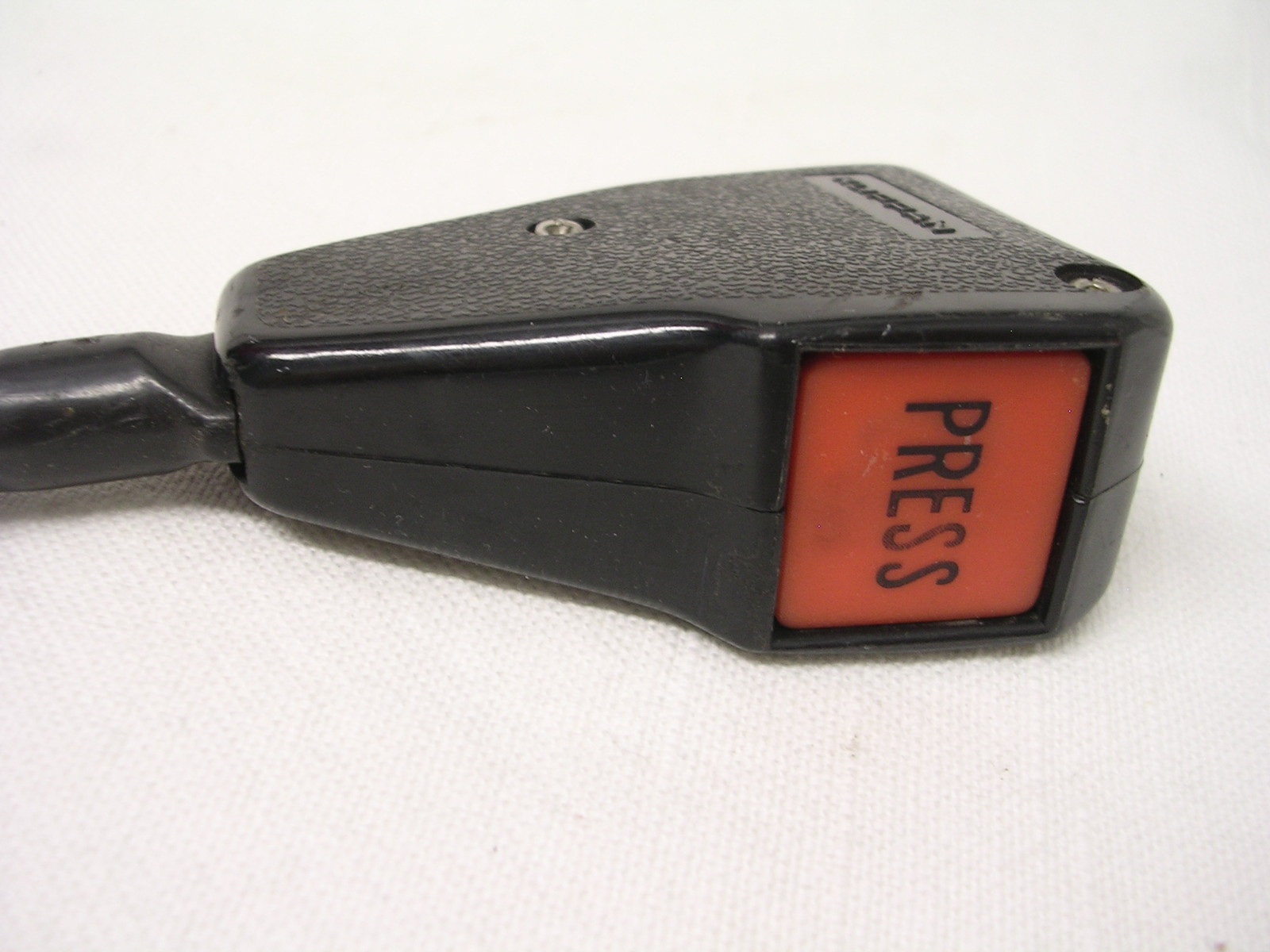

My seat belts are different than the "MKI" belts posted by Berger. They are more like Tim (Compunerdy's) links above. Here are mine compared to Berger's photo and Tim's link for an Alfa Romero (sequence is 1st photo = Tim, 2nd = Berger's, 3rd = mine).....
Sam

Posts: 1639
Re: Seat Belt release (orange button)

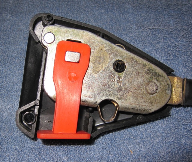

The original Pinz seat belts that I have seen are unique to the Pinz. There have been many other aftermarket seat belts used with success. I have a set of Beams seat belts on my '73 and they work great.

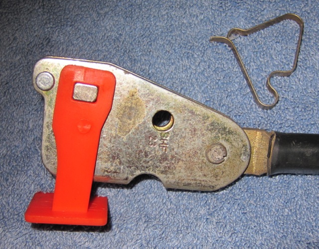

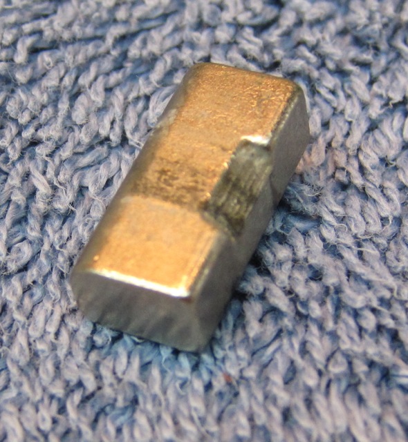

I have a female buckle that I keep as a spare and took it apart today out of curiosity. The orange "PRESS" button cannot be removed without drilling out the 2 rivets and carefully snapping off the 2 halves of the cover. In doing so the spring is released so be sure to notice it's placement before removing the bottom half (see photo). To remove the button, the metal pin that the male buckle connects to has to be removed. It too has to be replaced a specific way for the male buckle to latch correctly.
Posts: 1639
Additional photos:
To answer the obvious question, sorry but the buckle is not for sale. I would check with Scott at EI and Dennis Williams at Linden Engineering to see if they have some used female buckles available. Or maybe another forum member does?
Hope this helps.

Thanks Paul for the great photos and the time that you took. I guess my button disintegrated more tha I thought as my orange button appeared to me to just press into place and not attach the way your photos indicate. I'll check with the sponsor at the beginning of the week and see what they have.
Does anyone think the Alfa Romeo seat belt (see Paul's link a few posts above) is the same as the PINZ wrt the release button design?
Sam
'71 710K
Posts: 1639
The Alfa Romeo one certainly looks the same to me other than that the cable portion is much shorter on the Alfa. I would expect that the internal parts are the same.
